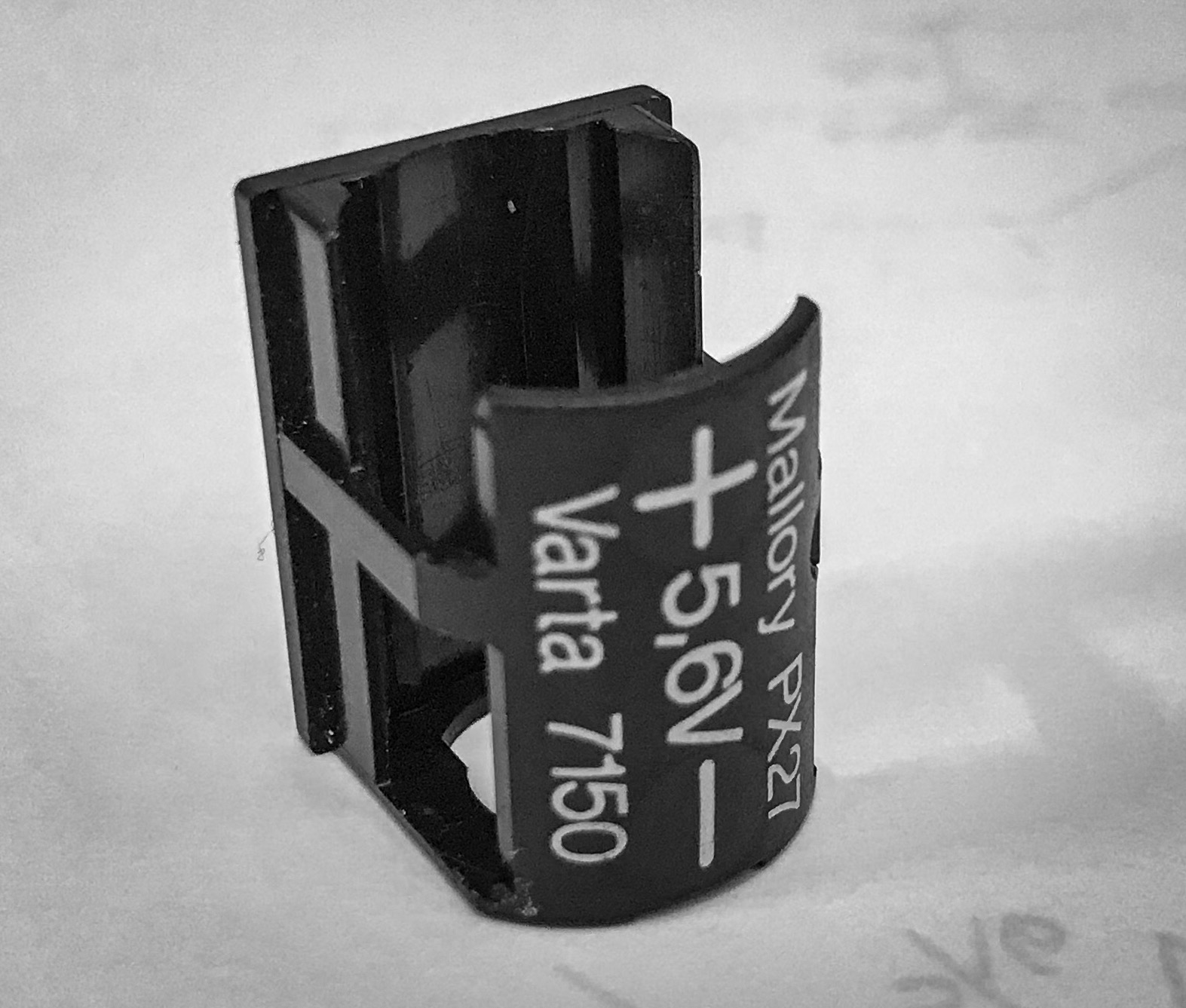

Any recommendations for who does do CLA on these?
Any source for the V27PX 5.6V batteries? 6V OK with the meter?

A good source for the batteries?
My solution for battery. Original PX625 (mercury) not available. Dimensions 15.2x6mm. Replacement SR44 (Silver). Dimensions 11.6x5.4mm. Find O-ring with ID 12mm, OD 15mm, install in battery compartment to keep the smaller SR44 centered. And yes, the calibration is affected. I adjusted some potentiometers below the top cover; alternatively you can establish that the higher battery voltage (1.55 versus 1.35V) causes an under-exposure of... 1EV?? or?? and adjust the ISO/ASA setting accordingly. Or, use a hand-held meter. Or, teach yourself to use Sunny 16.

Ha! I'll go with my light meter I think! The SE takes a V27PX mercury battery 5.6V.
Ha! Then it's simpler ! Minox 35 takes originally same V27PX. I know from personal experience (experiments, not internet rumors) that for the metering of the Minox 35 the battery voltage is not critical, and I'm guessing/betting that the reason behind 5.6V versus 1.35 is, for the Rollei 35SE like for the Minox 35, to power a proper electronic circuit (as opposed to a plain series connection, of LDR, battery, resitor, galvanometer), with an operational amplifier and what not, and that the Rollei 35SE is equally tolerant.
Bottom line. Take a piece of paper, roll it into a cylinder to line the inside of the battery compartment, for electrical insulation. Drop/insert four SR44 bateries, checking that they are properly oriented. Close. Shoot.
Warning: There is a battery type called PX28/4SR44/4LR44. Don't be fooled by the name. It is longer (25.2mm) than the four discrete SR44 (4x5.4=21.6mm) that I recommend.

Thanks, this could work, but the SE has a battery holder in which the original battery ends protruded slightly to make contact in the camera. I'm not sure the SR44's will protrude enough. Could work, I'll measure my old battery I had in the camera.

I measured the V27PX I have, it's 20mm long (20.04 actually).
I see that there are Exell S27PX 6V silver oxide batteries out there as an alternative. Cost is about $13. each, expensive, but probably not much more than piecing together button batteries.

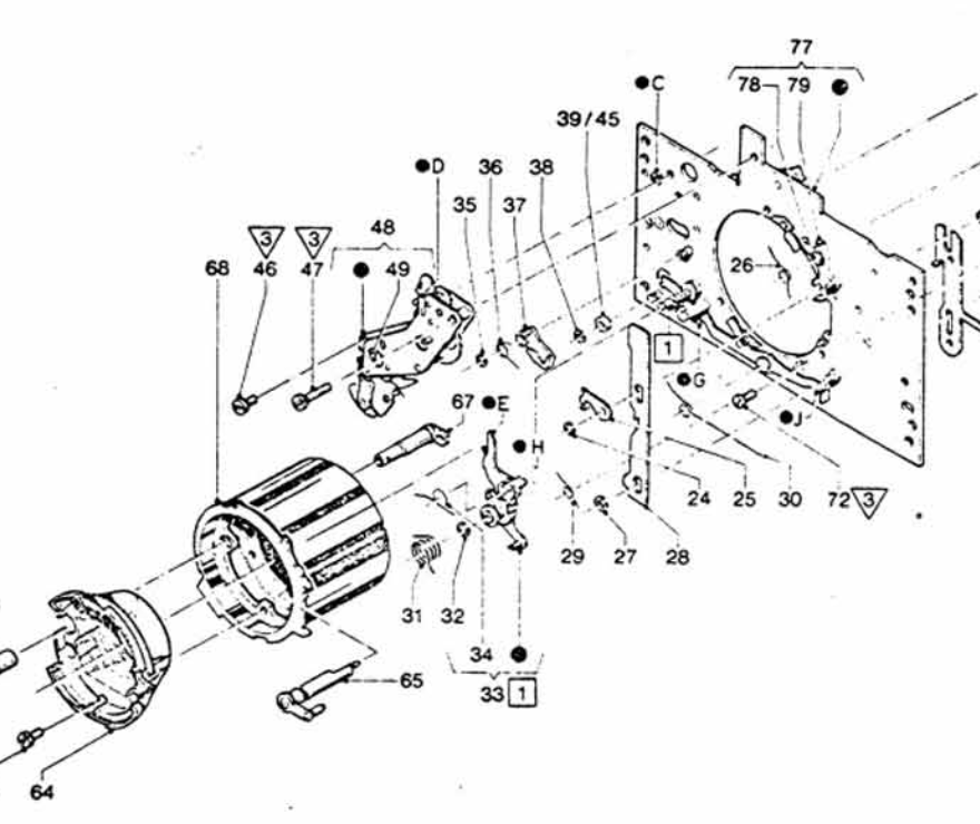

ic-racer
Feb 25, 2007
16,669
USA
The escapement is #48 in the diagram. The cause of slow shutter speeds, likely resides in that component.
