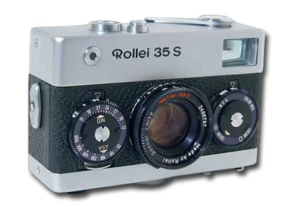

I have a very nice (looking) Rollei 35s (Tessar glass) (circa 1966) "made in Germany by Rollei" model and it doesn't seem to want to load. I have followed the directions but the winder seems stuck (or locked? it really feels locked). I know this camera isn't exactly intuitive but I find it hard to believe the camera is broken. Or I want to believe it isn't..
The meter battery is assuredly dead (1.35V button cell) but that shouldn't prevent the camera from working..(or at least winding..right?)
Are there any known tweaks with cameras like this? Such as unscrewing something and resetting a winder, a lever, etc?
Thanks!

Usually, the loading procedure is this:
1) Extend the lens.
2) Unlock and remove the back.
3) Flip down the pressure plate.
4) Insert new roll of film.
5) Insert film tongue into top slot of takeup spool. There might or might not be a set of arrows.
6) Advance film using either the serrated thumb wheel (not sure if this was on the early Rolleis) or the film advance. You might have to trip the shutter, which is why you have to extend the lens.
I usually let film wrap around the takeup one complete turn. Then I replace the back, lock and you can advance-trip the shutter until the frame counter reaches zero.
Are you sure it's a 35S? That's the Sonnar model and that was only made in Singapore, as was the 35T(essar). The first Rollei 35 had no letter designation, because they all were made with a Tessar.
I ask, because early in the Singapore production, a key part of the film advance used a nylon gear, which was prone to damage when a heavy-handed user reached the end of a roll of film and forced the film advance lever to the end of its travel.
That part was later replaced with a metal gear.

The take up spool mechanism is likely full of very dry and hard grease. It will have to be taken apart and cleaned, and re-lubed. The camera is likely to be worth the repair cost.
The battery can be replaced by a zinc/air hearing aid battery type 675, which I buy in an eight pack at WalMart for about 7 bucks.

You may be right- the problem is that it literally feels locked- it'll move a little and then it won't budge at all...So no reasons why this would happen other than a mechanical problem? It truly feels like a safety is on or something.
Does the battery have any logic to do with the camera operations other than the meter?
Thanks for the reply.
bill williams
Mar 11, 2005
73
The battery only powers the meter. If you've done everything according to the instructions then I'd bet as mentioned either the gear or the grease.

I think you're right on a jammed gear. Pretty handy with fixing cameras but was unable to figure out how to remove the top casing- removing all the screws there must be some trick to removing the winding level (those two tiny holes) and it looks like I have to remove the shutter button as well.

You can try 2 things: extend the lens and lock and set the little handel to "Rewind" and check if the windspool moves freely.
Then try to wind the film and release the shutter, see if that works. All can be done without film in the camera.
If the housing states 35S and it has a Tessar lens in it, somebody swaped lenses on this camera and could have messed up the filmtransport.

Arch it's not actually a 35s (but looks like it)- it's an original with a tessar lens....Not sure where I came up with the S--maybe a website...Either way. I did what you suggested but no deal....the actual spool winds freely but the shutter won't fire...It truly seems jammed or locked/confused. The camera is 100% original as from the original owner.

To remove the top deck, it's best if you have a spanner wrench.
Remove the screws on either end.
Carefully remove the cap on the rewind lever. Carefully remove the small screw that is to the right of it about 1 inch (2.5cm-3cm).
Carefully remove the cap on the film advance.
I say "carefully," because it's easy for the tool to slip and scratch the camera.
I can't recall if there is a threaded collar in the film advance. I think not. If there is, remove it. The top deck should now slip off easily.

You can be assured it's not dried lube! If it doesn't have a broken or stripped gear(different symptoms) you may have a loose screw. Well not loose but migratory stuck in the gearing. Seen this a lot on the A Canons and sometimes Spotmatics..
The screw holding th wind lever is the one with the two holes in it. It's made for a spanner wrench but a rubber stopper can be used to loosen it.
Firmly press down on the screw and turn the stopper. If no one has used loctite on it it should unscrew. There are three washers/spacers under the screw note the sequence they're in so it can be reassembled correctly.
If a sealant has been used a soldering iron can be used to heat the screw head & break the bond.
1) Extend the lens.
1) Extend the lens "and twist lock until you feel/hear a resounding click."
NOTHING shutter or transport related works until the lens is clicked into shooting position. And remember the shutter has to be cocked otherwise the collapse button to put the lens back in the body doesn't work. When the shutter is cocked the wind lever doesn't ratchet freely, it becomes fixed in the neutral position.

Neelin, that was it! Thanks man! It was that "click" that made it all happen!

Hey, I had the same problem and I removed the upper alluminium hood and tried to fix it(it weas really hard to remove the small knob with the R sign) and I found that the problem came from the small metal disc that is just above the film holder, and the previous owner was trying to load the film too hard and and disc was in another position that blocks the shutter button, so you just have to put it in the right position. My mail is closedctv gmail com write me to explain you
