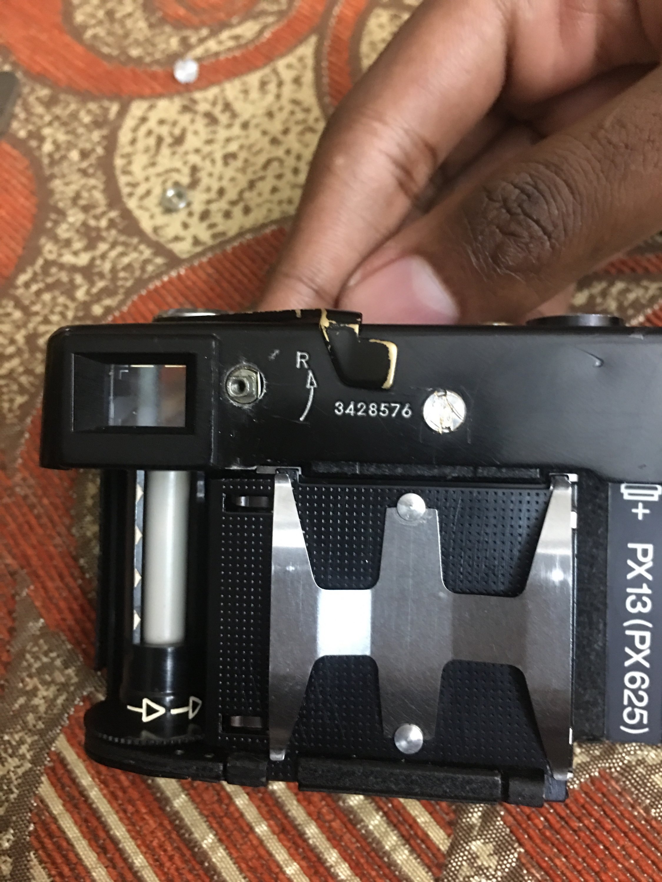

Alright tried putting in the rewind keys/ little piece of metal and I'm not getting it to rewind at all.
So I just put in the little knob. I know the smooth side should facing the wire. Then I turn clockwise so it's pointing at the bottom of the camera. When I add on the handle it doesn't turn down at all. I'm confused with what to do next
I also watched the disassemble video on utube but that isn't detailed enough. It's my 4-10 time taking it apart and I have no idea what I'm doing wrong
When the rewind lever is up you should be blocked from winding the film advance.
If you have not figured it out yet ... I made a note about this: https://oldcam.wordpress.com/2016/05/15/the-rollei-35-fix/
see the bottom of the page
It's been a while, so I think there is a pin on the other end of it.
