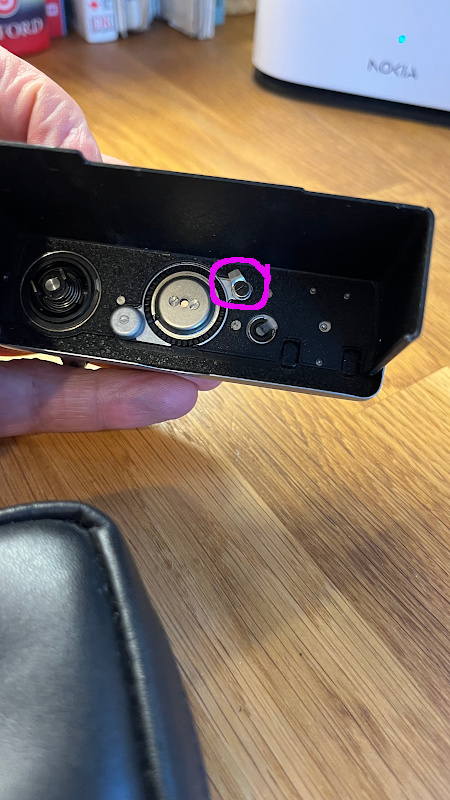

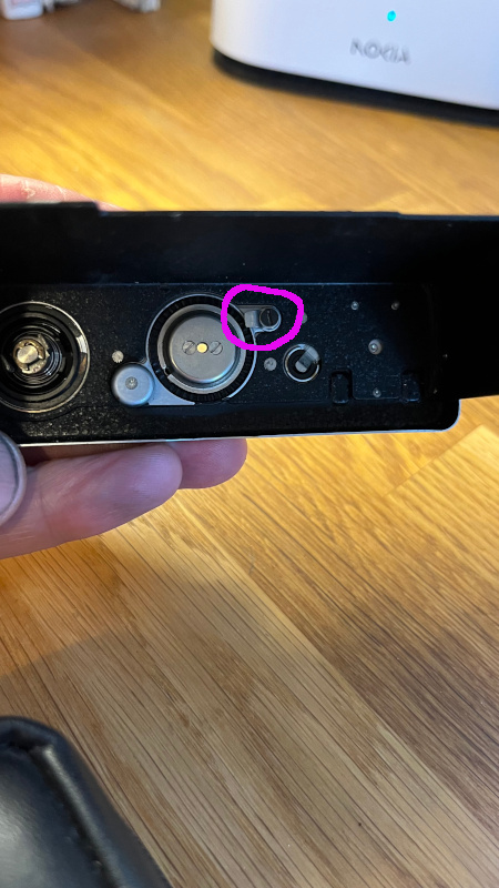

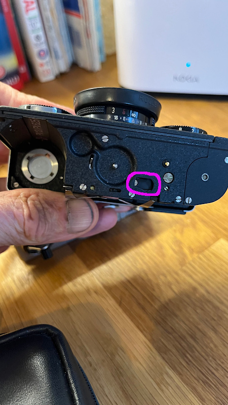

Not sure if this is correct thread, sorry if not. My Rollei 35 just supprised me and the bank cover does not open anymore. The level in the bottom is stuck and so does not move out. Tried all the combinations with retracted lens, not recreated. The R lever out and in, nothing works. I guess I need to find a technician, do I ? Thanks
The lever in the base plate is attached by a slot-head screw to a simple lever on the other side, which latches on the edge of an elliptical hole in the inner bottom plate of the camera. It's a simple latch and as far as I can see it has no interaction with other controls.
I thought it possible that the slot-head screw had come loose in your case. That would be a real pig. There's no way to access that screw through the lens opening, because of the pressure plate; and in any case the inner and outer bottom plates are being tightly held together by that lever.
However, if your lever simply won't move, that's a different problem. I hope others with lots of repair experience, like @Andreas Thaler for example, will be able to suggest a course of action or a repairer. Failing that, I would be inclined to apply a very small amount of lighter fluid, and see if that frees it up. It's such a simple latch, it's hard to see that there can be much wrong.
View attachment 378588View attachment 378589View attachment 378590
I would see if I could get to the spot by dismantling it.
Otherwise it would be an attempt at repair without visibility, which is always risky.
The back of the Rollei 35 is made out of very thin material and prone to warp. Maybe try pushing the bottom of the camera inwards and at the same time working the lever.
