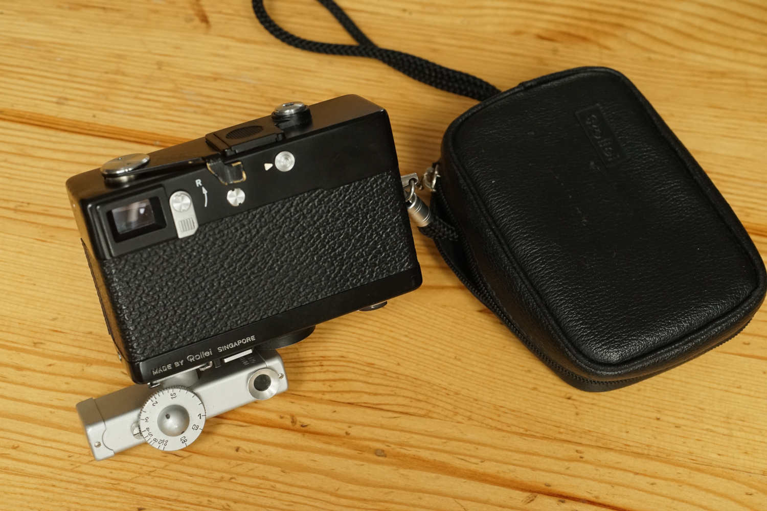

I admit that the Rollei 35 will never be able to replace (for example) my Contax IIa/IIIa. Let alone Canon New F-1 or Contax RTS II. But it's a handy tool in situations when I'm under way with persons who have absolutely no understanding for a fool who dwells on taking photographs and is carrying around all that old gear 😆.
It's cumbersome and gave horrible shooting experience. The image didn't impress me
Sure, its body does have its own aestetic programme 😉. But under those circumstances I mentioned, the Rollei 35 works well for me, even with its wide open Tessar:
I noticed that I could even use shutter speeds like 1/8 sec. (like on the pic) if you know how to handle the shutter release button.
My last idea is to try a Medis rangefinder from late 50s or so that I found in my crafty box - have not yet tried because it's "a bit" unwieldy, I admit 😙:
