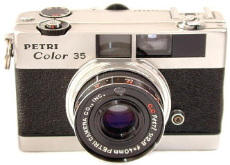

The Petri Color and Color E are no larger than the Rollei 35, like the Rollei it is scale focus, the standard Color shows the chosen distance in the viewfinder as well as the exposure. Petri made very good lens, even the SLR lens are as good as any I have used. Check out Stephen Grady's Camera Quest site for additional details.

Petri's Masterpiece: the Color 35 Family
Simply put, the 1968 Petri Color 35 is a design masterpiece. Elsewhere I complain about the Rollei 35's odd, hard to work design. The Petri Color 35 came two years later and is the camera that the Rollei 35 should have been. Where the Rollei 35 is odd and hard to work, the Petri Color 35 shines in originality and ease of use. Of course all of this is VERY odd, since saying a Petri had a much better design than a Rollei is something like saying Yugo had a much better design than Ferrari. I don't have a clue how the Color 35 design came to Petri, but I bet it's a fascinating story. According to the Collector's Guide of Japanese Cameras, the Petri Color 35 has the distinction being the first Japanese camera to have the distance scale and exposure scale in the viewfinder. Most Color 35's are chrome. The harder to find black enamel finish is more desirable.
The chrome version with black lettering is the most numerous Petri 35 in the US. Even though a small camera, the controls are large and easy to use, especially the film rewind lever. The chrome button to the right of the shutter and aperture dials is the battery check.
  • Elegant Scale focusing full frame 35mm camera with match meter needle exposure
  • Very small, compact all metal body
  • Mechanical Shutter, works without batteries, 1/15th to 1/250th plus B
  • Unlike the Rollei 35, all controls are conveniently located where you would expect
  • Collapsible 40/2.8 Petri CC lens, 4 elements, 40.5 mm filter size
  • Distance scale and meter needle IN the large and easy to see finder
  • A unique design which cleverly places ten controls on camera's top edges
  • Clever design with top mounted dials for focusing, aperture, and shutter speeds is fun to use
  • Focusing, f/stops, shutter speed, lever advance, shutter release ALL easily operated from eye level
  • Large and easy to use film advance lever and film rewind lever. The film advance lever is even in the right place, on the top right -- not the top left like the backward Rollei 35. Better yet, it's a short 130 degree advance.
  • Top mounted hot shoe. I never thought I would made a big deal about something as ordinary as this, until I tried the Rollei 35's bottom mounted hot shoe
  • PC flash connection as well as hot shoe
  • ONE, yes one, strap lug: the small Color 35 was intended to hang from your neck or wrist strap.
  • Match Needle CDS metering system, EV 7 to 17 at ASA 100
  • CDS meter in filter ring, takes filter corrections into account
  • Meter ASA settings 25-800, set by rotating ASA dial around lens barrel, strangely enough it rotates 360 degrees
  • The Meter is designed for the Mercury 1.3 v Mallory RM675 or equivalent, but in practice the 1.5 v alkaline or silver 76 batteries have worked fine for me.
  • Battery Switch: the meter is only on when the film is advanced, shutting off with each exposure
  • Battery Check: set the shutter speed on B, the aperture on 22, advance the film, push the small battery check button located near the shutter and aperture dials. If the meter needle is in the circle or above the circle, the battery is good, if below the circle replace the battery.
  • Camera back has tiny "feet" on each corner, to elevate camera base and keep it from scratching -- gee, that's a nice touch Leica, Nikon, or Canon could benefit from
  • Threaded shutter cable release
  • Tripod socket
  • Removable back for very easy loading

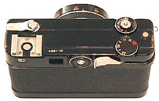

Top Plate Design Award: 3 easy to grip dials control shutter speeds, f/stops and focus, focusing dial also collapses or extends lens, large easy to use film advance lever and film rewind lever, hot shoe, film counter on back edge near hot shoe, shutter release threaded for cable release. The small window on the back edge of the top plate, below the accessory shoe, is the film counter.
Was the elegant Petri Color 35 Petri's best ever design? Well, I guess that depends upon who you talk to, but in my eyes, it wins hands down. If you like "different" cameras with noteworthy features, this little Petri may become a favorite of yours too.
