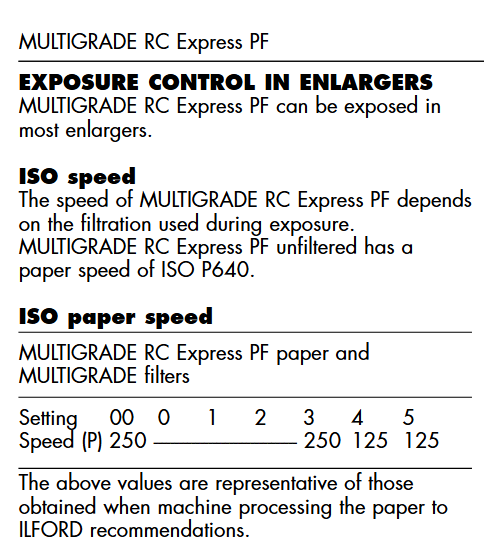

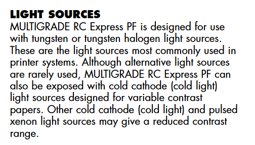

Product Description​
ILFORD MULTIGRADE EXPRESS PF is a high speed, variable contrast black & white paper on a bright white, resin coated base.
It is specially designed for high speed printing applications and compatible with all conventional black & white exposing and photo finishing equipment found in professional labs, including automatic and semi-automatic printers, printer-processors and minilabs.
_______________________________________________________________________________________
I don't know why there's no link to the MG RC Express data sheet, I have a copy.

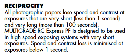

The ISO Paper Speed doesn't differ much from other MG RC papers, except for Warmtone.
The major difference appears to be almost no reciprocity failure with the very short exposures, essential the paper is optimised to be used at at an exposure time of around 50 milliseconds (1/20 )for a normal negative, using high intensity, oft more than one lamp, continuous light, and a shutter control exposure.
There are no issues using these papers conventionally. I've been using a roll for a while now. They might be an advantage for paper negatives if the greatly reduced reciprocity is mirrored at the other end of the exposure range. A 12" roll would be useful as I have a 12"x10" field camera.
