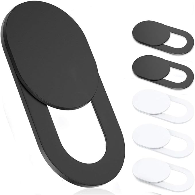

For peace of mind, you can stick on those "webcam privacy shutters". They should be light proof, when you slide the window closed.
