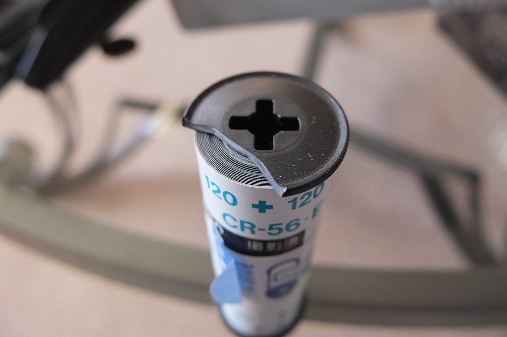

I found a surprising problem today while packing up my film. I shot my very first roll of Velvia 50 (after 20+ years of shooting film), and this is what it looked like this morning.
Has anyone ever seen a failure like that before? Disappointing as I have some nice shots on that roll that are now heavily compromised. :mad::cry:
I wonder how this happened. I never felt anything weird while shooting with it in the camera. Just smoothing rolling all the way through.
I'm pretty shocked as I have NEVER seen a film roll fall apart in this way. Ever.

It was in my laptop computer bag or my jacket pocket. I've been traveling a lot and can't trace its history all that well. To my knowledge, it should have had had huge abuse but who knows, perhaps I made a boo boo.

The face of the break is consistent with an "all at once" break. Defects in material are normally pretty easy to see along a fracture.

Where did you find the broken off segment? In your pocket or in your bag? That would give you a clue as to where it happened and it probably wouldn't have needed much of a bang/squeeze. Note that pressure on the roll of film can affect the image too - squeezing it against a hard edge for a moment, or two, can be seen when developed. Always better to carry it in protection of some sort I'd suggest.

It's probably just a rogue faulty spool.
I think this is most likely. As an engineer, I know how plastic molding can sometimes cause a failure. This could happen at the beginning of a run when temperatures haven't stabilized. Usually the first parts are ground up and reused, but one could escape and get in the finished parts.

I found the broken chip. It was in my jacket pocket. So that means that putting my GF670 into my pocket while the film was in there somehow managed to damage it. That is NOT a lot of pressure or energy to break the roll.
If the film was in the camera when you put it in your pocket how is it possible to damage the spool while in the camera and presumably protected by the film compartment?

This Isn't "roll film failure"' it's roll film spool failure.

Let me be more clear. The film that was broken was fully exposed and then put into my pocket. Then while shooting a new roll of film, I would put my camera into my pocket, the one with the roll of film that got broken. Somehow putting my camera into my pocket was enough to damage it.
