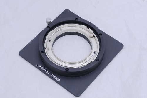

I know there are some adapters out there that permit using lenses designed for the RB67 - including the 50mm - on 4x5 cameras. That lens will most likely cover 6x8, but may not stretch to 6x9.
Hmm, I wonder how the shutter is triggered. I’ll do some searches. Perhaps I’d be best off just getting a LF 47mm.
The shutter release uses the mirror up release on the lens. The adapters control cocking the shutter.

Excepting lenses for the RB67, if you can deal with the shutter cocking.
You can adapt RB67 lenses to a 4x5 (or other) LF-sized cameras, but they are designed for 6x7 coverage, not 6x9. -- as Matt mentioned Plus, they are all very large and heavy -- although prices are pretty reasonable nowadays.
Here's how I adapted my RB 37mm fisheye. Works fine -- because it's a fisheye lens -- once you get used to how the shutter has to work, that Dan and Matt mentioned. That adapter board makes things much easier, but won't change the coverage limitation, the weight, or the size. The 37mm weighs about three pounds, for example.

one possible benefit of adapting RB lenses is I believe that the wide angle lenses on a RB are all retrofocal so they don't interfere with the mirror, so if you can focus a 100mm lens to infinity, you can focus any RB lens to infinity. (the FFD on RB lenses is 112mm, so even the 37mm fisheye gives you plenty of space.) On the negative side, the wides are the least likely to cover 6x9, unless you're focusing clock.
I have that RB adapter board I linked to, but I haven't done anything with it yet, but I thought it might have some use so I snagged one a while back.
The long flange focal length of the wide-angle RB lenses won't be of much help because the image circle is still pretty small at infinity. You might be able to squeeze a little shift out of them, but no much. Better than nothing, I suppose. It sure would be a help with macro work -- however it would be smaller, lighter and cheaper to get a normal LF macro lens.
I no longer have any RB lenses -- except the fisheye. The only one that makes any sense on 4x5 is the 37mm. If using a medium format back, it seems more sensible to stick to the lenses you have -- or get some wider optics if needed. If you have a 90mm, 75mm, 65mm or whatever, even if it covers more than the roll film back, why not use it -- for both formats?
