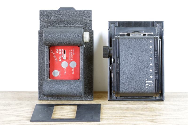

Here are two 120 rollfilm backs for 3x4 Graflex SLR.
The one on the left uses masks for 4,5 x 6, 6 x 6 or 6 x 9 cm ; it was made by Suydam, California.
I mainly use the better made Graflex, with non RB 3x4 (Series B and Auto-Graflex) which accepts the 5" lens of 2x3 RB (same threading). So, focal length is not too long...
