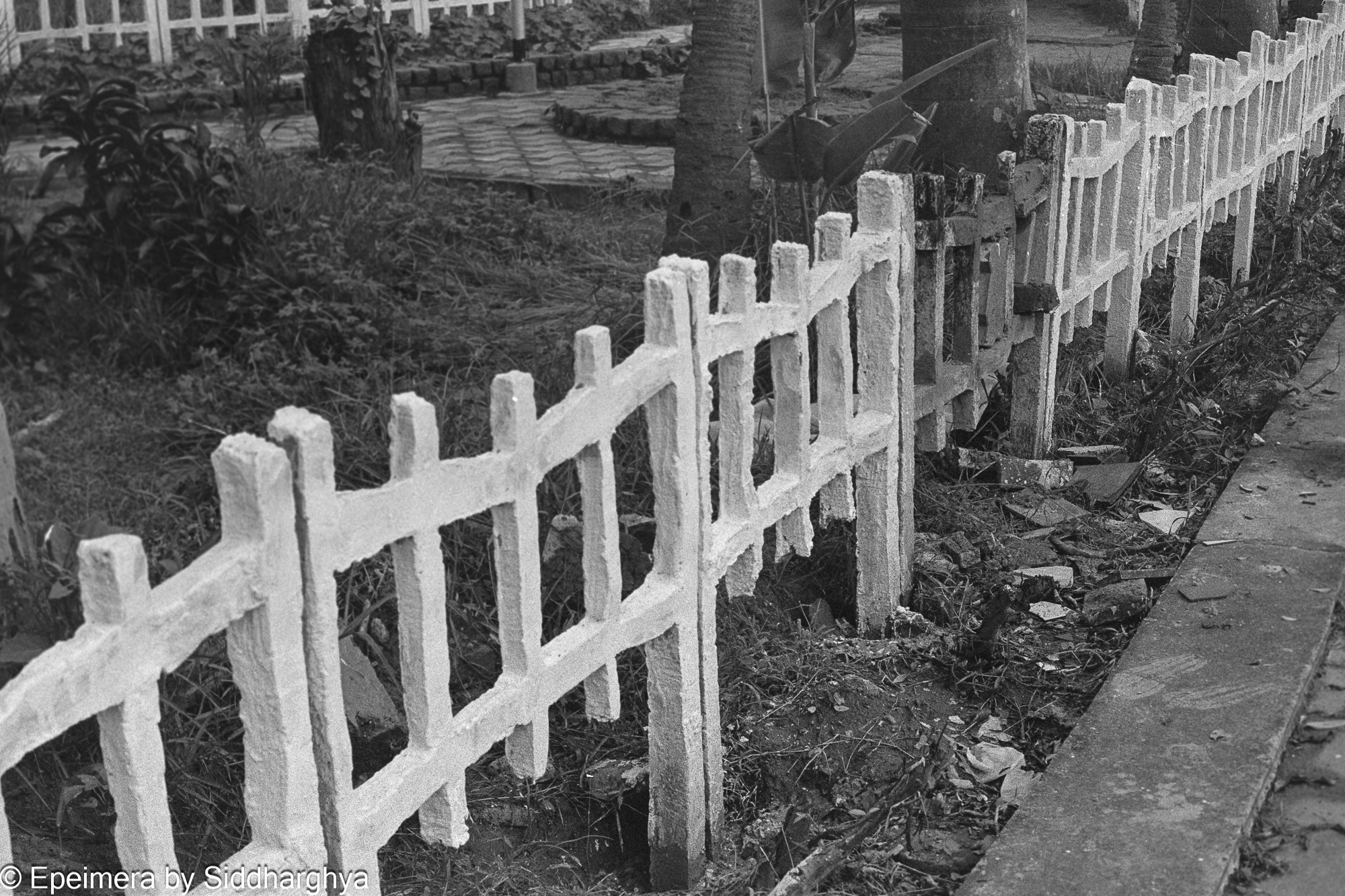

Below I have inserted 2 images of the same scene, taken last Saturday afternoon under the same lighting conditions, on the same roll of Kodak XX 5222. The first was developed in Rodinal 1+50, using Patrick Gainer's calculation of Wolfen formula.

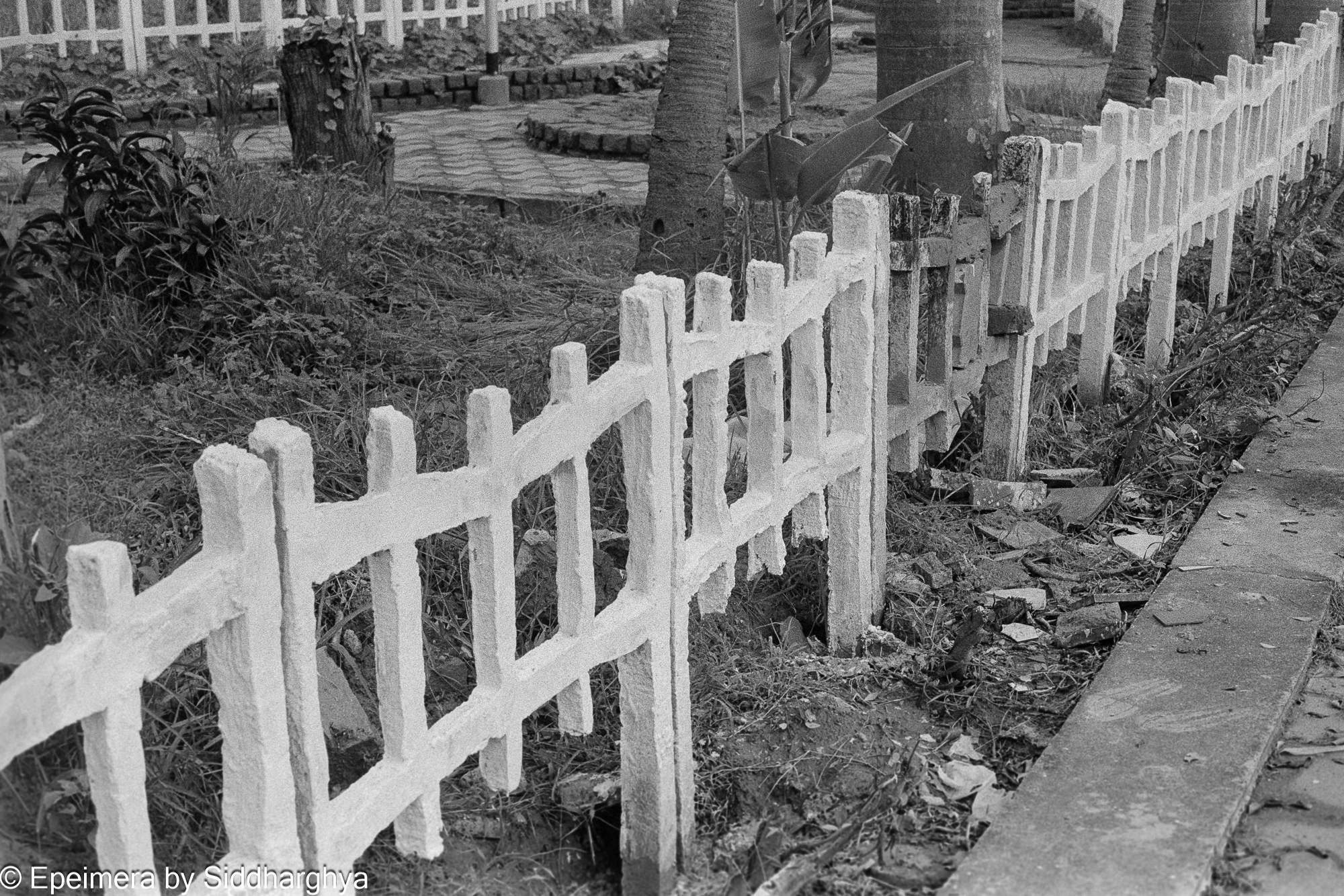

The Second one was developed in the same Rodinal 1+50, but with addition of 4 gms/Lt. of Na-Ascorbate.
Please judge whether there is any difference.

I prefer the second photo, because tree trunks in the background are better defined. But when making comparisons, making the development times produce the same contrast requires some trial-and-error. The second photo might have been able to be made from the first negative by printing at a higher contrast.
View attachment 375087View attachment 375088
It looks to me like the second photo (Rodinal plus ascorbate) has a little more shadow detail and highlights that are less bright.
I tried to adhere to Gainer's directions for using the developer, including timing.
Yes, and consequently the second image is less punchy. Doesn't the first image show more "Rodinal look"?

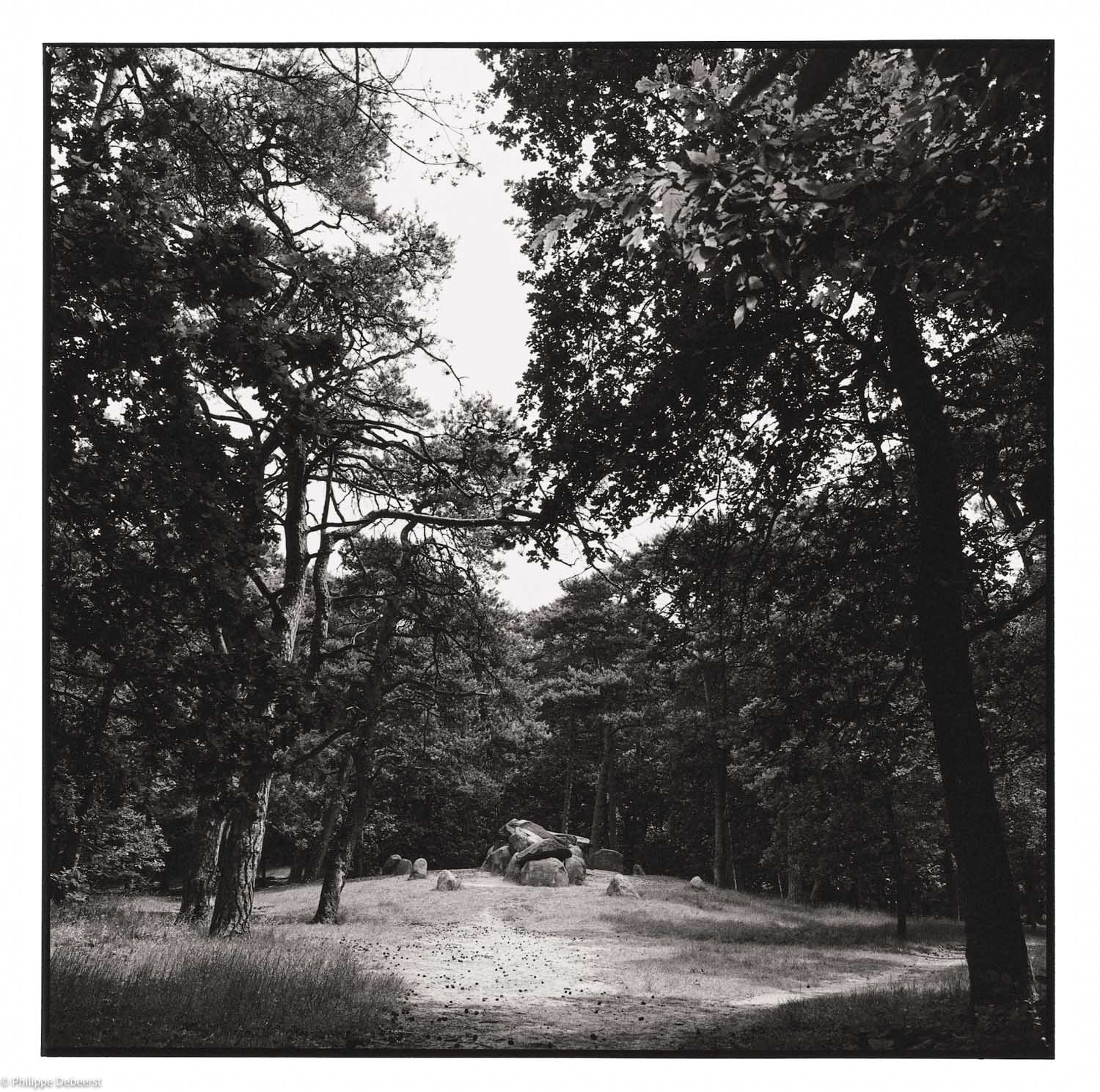

I tend to prefer the first version, although neither of these are my cup of tea.
To my very personal insight, both lack nearly open whites and deep blacks.
If that kind of print would come out of the developer in my darkroom, I would not keep it.
But again this is a very, very, personal opinion!
Below you see a scan of a print (done by a professional photo engraving service) from my book 'De Stilte Der Stenen' on Megaliths (2000).
It was shot on AGFAPAN 400, developed in plain Rodinal 1+50 and printed on AGFA MCC III FB (24x24cm).
Only, the internet's low resolution doesn't show the full range of details as can be seen printed in the book.
Hondsrug, Drenthe, the Netherlands; Hasselblad SWC/M and Yellow-Green filter.

Definitely, lowering resolution is an important issue. The full resolution images, as I viewed in my monitor shows better.

Gainer speculated that adding ascorbate would reduce the grain whilst keeping the "good" properties of Rodinal.
Grain difference might be visible on a crop from a scanner approaching 4000 dpi true, but not from the two pics posted.
You have a lot more information on the 2nd image
You can manipulate the digital to match the contrast on the 1st

The contrast of the examples in #28 isn't adjusted to the same level and I guess it also isn't in the negative. Way to go, before one could start drawing conclusions.
