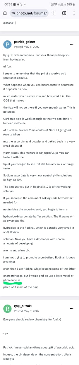

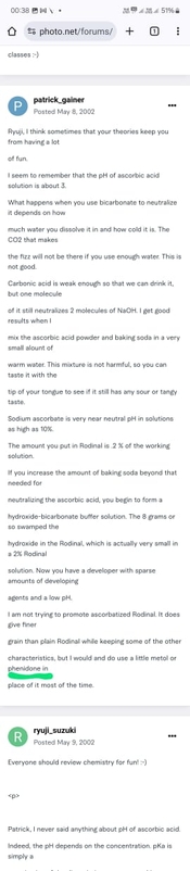

Last night I found in photo.net thread -"Rodinal with Ascorbate - what am I doing wrong???" from May 2002, a comment by Patrick Gainer himself dated May 8, 2002, where he said that, if I am not very wrong, he tried phenidone in Rodinal. I am enclosing a screenshot of his comment, but he did not specify or elaborate on the topic.
