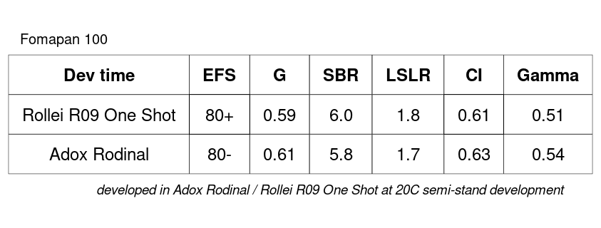

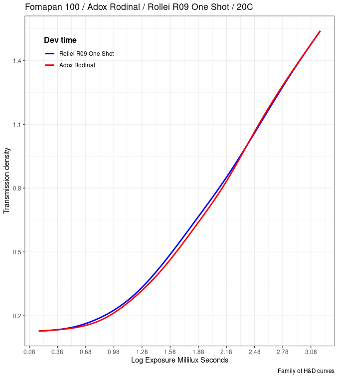

I tested Adox Rodinal and Rollei R09 One Shot and found them to produce nearly identical results, at least for my needs, using a semi-stand development. This is far from a definitive test, but, in my experience, I can use these two interchangeably. In other types of development, the differences might be greater. I am planning to test this further.

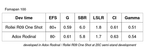

Here's a summary table, comparing Rollei R09 One Shot and Adox Rodinal in 40 min. semi-stand. The differences are very small, but this is just one test. These differences could be greater or smaller in, say, 15 min. 1+50, or 8 min. 1+25, etc. This needs to be tested further to be sure.
