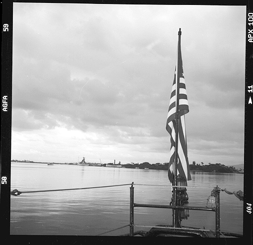

Studional with APX---Sharpness
Anyone use it with APX?
Yes, in '94 it became my main developer for all things APX. Beautiful tonality, fine grain and fine sharpness.
