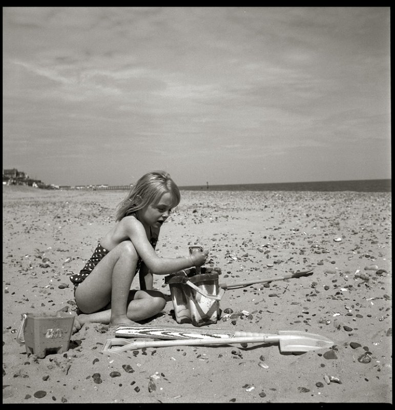

In the UK in bright sun I use 35mm and 120 HP5+ rated at 200, with a yellow filter. Typical exposure is f8 at 125th. I develop in Rodinal 1 + 50 as folows. 4 initial inversions then 1 inversion every 5 minutes, for 25 minutes. This not only controls the highlights but also boosts the shadows. Negatives print on grades 2 to 3.
In 35mm I have seen no edge effects, even on big enlargements, and get very nice tones. After maybe 50 films developed like this I have seen no uneven development. I have even started developing 5 x 4 film the same, in a Paterson orbital processor, and have had no uneven development even though the film is horizontal throughout development.
I got the recommendation to develop like this from D F Cardwell, here on Apug.
