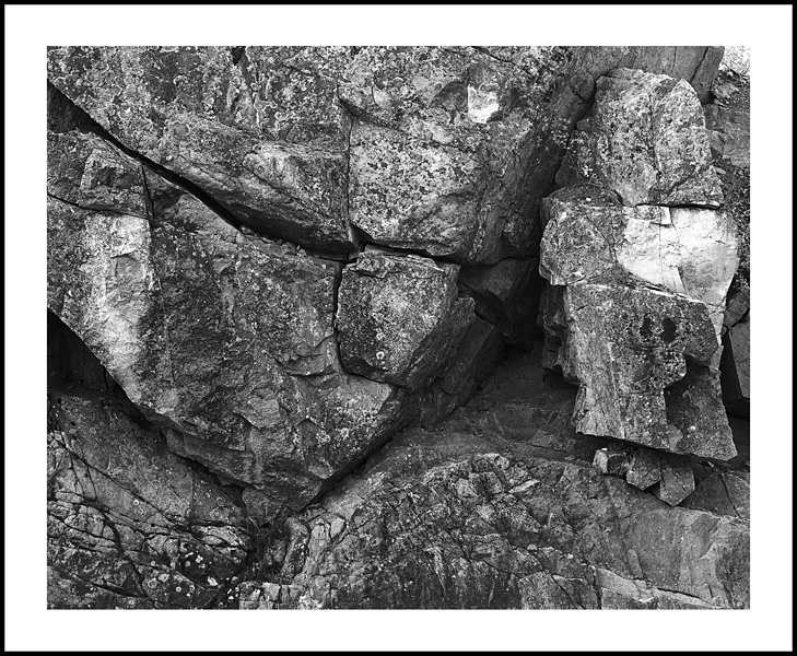

I have attached a neg scan from the 1+200 stuff. It's Plus-X Pan, rated at box speed. Got a natural boost in the high mid tones and highlights from the stand development, since lighting was a bit flat.
- Thomas
- Thomas
I guess I am confused. Stand development gives a boost in the highlights? Since the lighting was flat you did stand development to boost constrast?
I would think the logic of stand development would be that the developer worked far longer on the low tones and reduced contrast or gave a boost to the low tones relative to the highlight tones.
Thomas Bertilsson
Jan 21, 2003
15,715
Switzerland
The developer exhausts with a speed proportional to the density in the negative. If the density is a little lower, it will exhaust slower.
I guess the way I like to put it is that it evens out exposure errors. I'm not very good with a meter. It's a problem I have. The stand development gives a boost to micro contrast and shadow details, but I should perhaps word it to a statement of the stand development boosting definition in the negative. It just seems to give the image a higher impact due to the improved local contrast.
I think 'boost' is a vague term that I should stop using.
- Thomas
