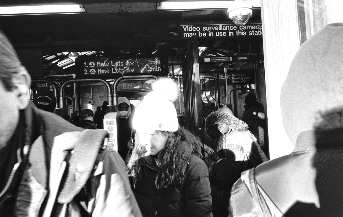

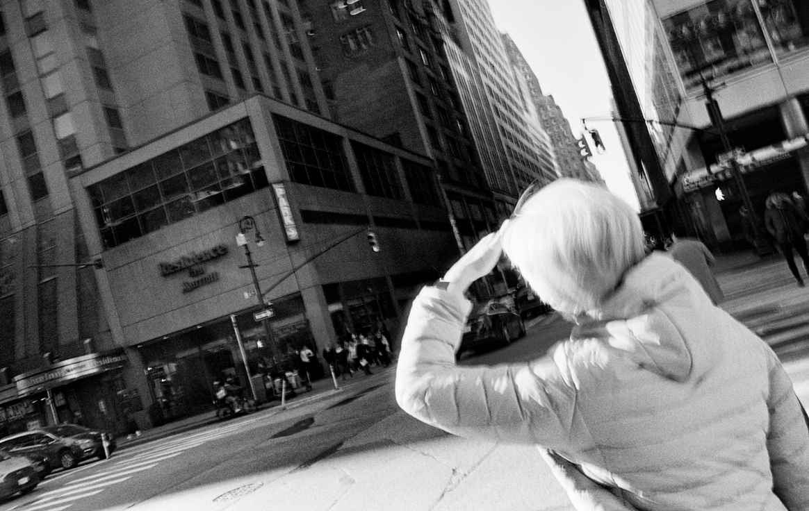

You're right, I didn't know what it's called, but this is what I meant.
The first photo is developed in 1:25, 13 mins @200
and the second in 1:100, 60mins, @64
As you can see on the first photo has a lot more 'glow' than the second one, however, conditions was almost similar in terms of light.
Alex Benjamin
Aug 8, 2018
2,870
Montreal
You're expecting the developer to correct problems you've created when taking the shot. Problem here is not development. Problem here is metering. Both shots are overexposed. You metered in order to get maximum info in the dark areas without taking into account the brightness range between these shadows and the highlights. Hence, blown highlights. Rodinal can't help you there with either "glow"or acutance. It's too late.
Second shot also has the problem that nothing in it is in focus. That, also, helps neither acutance nor "glow".
