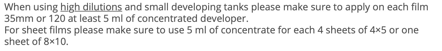

I cannot locate the Agfa data sheet where I had read that info. Adox states to use at least 5ml per roll of film, 5ml for 4 sheets of 4x5.
Thanks, I Iooked at my old Agfa Rodinal(the genuine Agfa Rodinal ) sheet and could find no mention of any min quantity but Ed Buffalo in his article "Appreciating Rodinal" does actually say that Agfa's recommendation is min 10ml but doesn't give a source for this However he goes on to say that he has found that 5ml is fine as Adox states
Mind you, the same Agfa instructions that I have state that once opened a bottle is good for at least 6 months. Now if that is not an understatement, I don't know what is :D I used my Rodinal the other week and from opening it has lasted now about 196 months :D

From an Agfa pdf on film developers (1999):
"Yield
One-shot developer.
With 500 ml concentrate about fifty films (135-36 or 120 rollfilm)
can be developed."
which could be read to mean 10mL per film.
And yes, I know that less also works.
