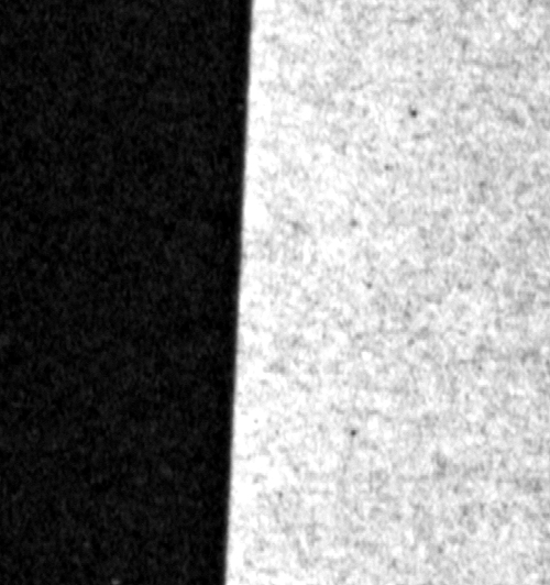

Since Mr Mackie first wrote about them 100 years ago, Mackie lines aka edge effects have interested some photographers.Here's my effort from Plus-X semi-stand in Rodinal 1:200 60min 68F, agitate at half time,0.1 in square section of negative. It shows a black card on a gray card and I hope it's possible to make out at the edge a darker line at the black side and a lighter line at the gray side.
Dilute Rodinal will do this but using Xtol first will eliminate the effect.
