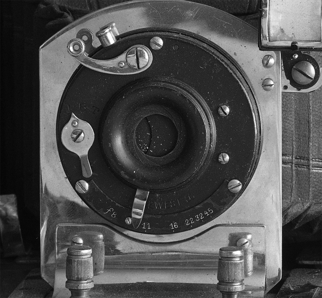

I've only taken a very few photos with this lens but it has impressed me with it's stunningly sharp images. Here is a screenshot (reduced for photrio) of a 100% image portion as shown in PS. Ya I know I should have dusted off the folder camera haha. The full image is in the gallery. Seems photrio compression kills a bit of the sharpness but you get the idea.

It's a famous lens for its sharpness on 4x5, including at infinity and not just close-up, provided you have the in-shutter version with the elements properly spaced.
