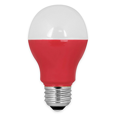

Do you know I I can use just a very low wattage(7) red led light bulb? I was told yes by a guy who does wetplates. But he didn’t know with this kit.

I would think you need a proper safelight for this material. Its NOT the same as a wet plate collodion emulsion.

think of it as photo paper, that is what it is ,, photo paper emulsion you are spreading on a piece of black metal,
so if you have a safe light you use for photo paper use it with the AG+ emulsion and you are OK...

I use a low-wattage Feit 3.5 watt LED "party light" led bulb from Lowes. It is commonly available at many hardware stores and home improvement centers in the US. It is the one with the lower half made in red plastic and fits a standard US household screw outlet. I point it at the ceiling and keep it 4 feet or so from my work surface. I use it for the AGPlus emulsion, collodion, and graded enlarger paper and have never had a fogging issue. I've done dozens of plates with this bulb.
