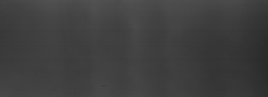

Ok, let us use an example of Plant X (UNNAMED BUT REAL) making film. They use a trough or dip coater at speeds of about 10 - 100 ft /min. IDK how many troughs they have in the coating train. They use open air festoon drying! This is about 1920 style production. This real facility is in operation only when the weather is acceptable for manufacturing film, as they have no air conditioning or drying capability. So, it can't be too hot, cold or wet!
I have posted an example of their film here previously which I am reposting here. This is a sample of film from a trough coater. It is typical of the result which gives a sinusoidal pattern to the coating. In addition, festoon drying introduces a defect at the point where the header racks are positioned at the ceiling. Therefore if you have a 40 ft ceiling, then the longest roll of film is either 40 ft (if you use bottom racks) or 80 ft if you use gravity to hold the festoon in place (not a good idea but possible). This limits you to making amateur roll films and prohibits motion picture film production due to length restrictions. Well, the sinusoidal density patterns will give you a nauseating headache on screen projections too. :wink: This is probably why some old motion pictures show light/dark variations in a regular pattern.
Scuff marks or cinch marks will be random over the surface of the film and cannot be detected easily without a sophisticated system. In fact, I would be surprised if the bulk of them can even be detected. This is worse with coarse grain, low gelatin coatings as the grains actually stick up as bumps on the surface of the coating and cinching causes streaks and foggy spots.
To continue, the new hardeners are so toxic and so quick acting that they cannot be used in a trough coater, as the fumes would harm the lead coater, and the trough would set up within a few seconds of being filled.
So, I've enumerated possible problems and actual problems at one potential supplier of film your film if Kodak, Ilford or Fuji goes under.
Now, to fix these there would need to be a huge capital investment that would add drying cabinets, hepa filters, undercut roller transport, multiple extrusion or a single slide hopper front end, containment and handling of a new hardener and that would bring the facility up to producing a modern film, or at least reduce the defects inherent in their current production. Of course this also would require an upgrade in the pumping system and the film transport system to eliminate that pattern in the attached scan.
The engineers at Plant X are amazing people to make what they do with the equipment they have, so I stand in awe at their ability, but I do have to show you the flaws as suggested by HRST. You guys are buying this film. You guys complain on-line about defects constantly.

Ron, interesting insight into a process many of us don't see. I'm curious about your point that the 40-foot (or whatever) ceiling limits them to production of "amateur roll films". I see where it precludes cine film, but what's "amateur" about 120?
I'm fairly sure I've used products from Plant X based on your description, and I certainly haven't run into anything that looks like the sinusoidal-density sample you posted. More generally, if they're the company I'm thinking of[*], they have plenty of users at APUG, and while there's a consensus that their QC and batch consistency aren't anything like the big three producers, I don't remember many cases of posters saying "My Plant X film is unusable!"---which clearly that sample would be.
I think it's fair to say that there are two possible commercial cases for film manufacture; one uses smaller-scale facilities and doesn't produce enough cash flow to make large capital expenditures towards modernisation feasible, and therefore essentially can't match Kodak/Ilford/Fuji in consistency and technical quality, while the other consists of, well, Kodak/Fuji/Ilford (and maybe the remaining portions of the Agfa complex).
You make a very good case that the barriers to entry are prohibitive for the second model, which is depressing, but I think many of us will feel like the world hasn't ended as long as some companies are able to make a go of it doing the first one.
-NT
[*] If they're the other plausible candidate, they have a somewhat worse track record but still have plenty of reasonable, discriminating people using their stuff by choice.

Nathan;
A few points here.....
First, 120 is not precluded except for handling problems with the thinner support. If they can handle it without kinking, then 120 is possible. I believe that this particular plant does do 120.
Second, complaints about the sinusoidal pattern were described here on APUG which is what led me to post it before. There are recurring problems that were seen in LF and 35mm IIRC.
Third, complaints overall range from black spots on film (pepper grain) to emulsion liftoff or separation from the support. This is either bad subbing, bad hardening, bad drying or some other similar problem in the coating operation.
Fourth, many complain about severe curl which is due to several possible things. They do not use properly tentered support, or they do not use a back coating to reduce curl, or they do not add humectants to the emulsion to prevent shrinkage.
These and other problems abound on APUG with a number of manufacturers. I am sensitive to them, because many people come to me for answers. I am only pointing out here what kind of problems exist and what upgrades would be needed to fix them and move into the mid 20th century including perhaps color.
PE
How do you know how this particular film was coated?
(Fair question?)
You said it is typical of the result which gives a sinusoidal pattern to the coating.... is this because a sinusoidal pattern is the best and only possible outcome with trough coating?
Or because more skill or tighter control is needed somewhere?
(Fair question?)
Ray;
I know exactly where and how this piece of film was coated It was sent to me in confidence for diagnosis with all added information needed to respond.
You seem to wish to question my every statement, but this one is exactly true.
As for the pattern, it is narrower with extrusion hoppers, and slide and curtain coaters give different defects.
PE

Ray;
PE
No offense intended... It is not that I WANT to question your every statement, it's just that I can see different interpretations... in this case you might have coated it yourself or that patern might be closely linked to trough coating... or, you might have just presumed as much based on production capacity... all of that rushed through my mind as I read your post, and I just wanted to be clear. Sorry.
Although you did not address the second half of my question, (slightly reformatted here as...)
Is the sinusoidal pattern the best and only possible outcome with trough coating?
Or can it be eliminated with more skill and or tighter controls?
I did find the answer embedded in an earlier post:
So no, you seem to agree that good results are possible with trough coating and that the sinusodial pattern you showed us represents atypical results that should not be expected when things are set up well.
