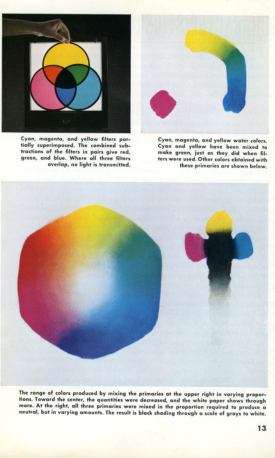

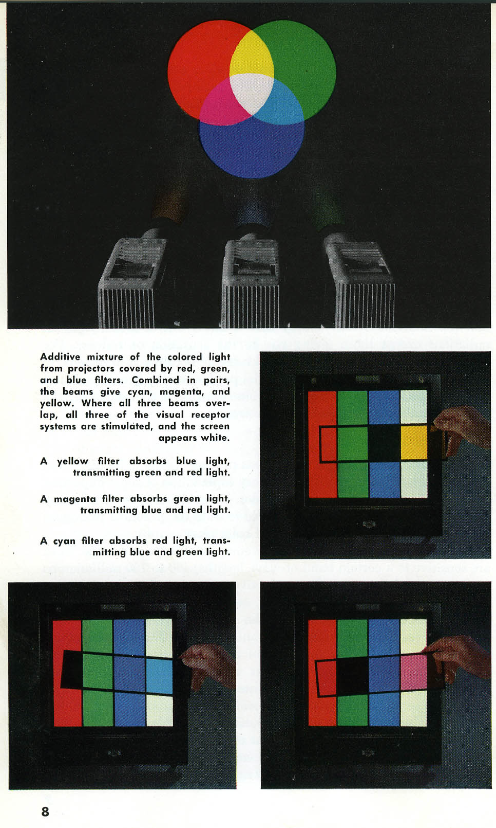

You want me to say Blue = wavelengths from 400 - 500? Who here understands wavelengths as color. Besides that is inaccurate in that it does not include the possible shades of blue.
You want me to say magenta is wavelengths from 400 - 500 and 600 - 700, but not from 500 - 600? Again confusing. Also inaccurate as there are many combinations that create all of the colors we see. This simplification is for the average reader.
The attached are from Kodak and show the relationships I described. I have posted it before.
Blue is the left of the spectrum, Green is the middle and Red is the right. Blue is absent and Green and Red are present in the area we see as Yellow, and Red is absent and Green and Blue are present in the area we see as Cyan. Magenta can be shown only by overlapping the Blue and Red regions and leaving out the Green regions.
But then that is shown in the other examples. And since they disagree with QGs world view, he dismissed them the last time.
But then, this is far far off topic. Sorry guys.
PE
