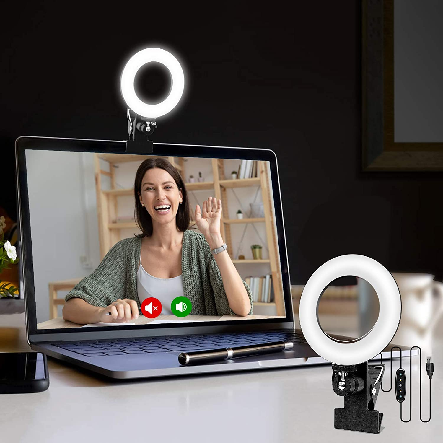

One of the reason that the "craze" might be waning is the prevalence of lighting for Zoom and social media that somewhat mimics ring light.
From an Amazon listing:
(And no, I don't believe that product was used to light that woman in the screen image)

I think the ring catchlites in the eyes for Zoom/YouTube are/were a desirable "look-at-me-I'm-cool-thing" & "don't I look like a professional YouTube presenter."
Certainly the clueless positioning of the light in the Amazon ad supports this cynical view. In the ringlight's defense it looks like it can be clipped to the laptop's screen and be swiveled to surround the PC's camera lens.

The small ringlight that Matt showed as an example is sort of the worst of all worlds because it's not large enough to effectively diffuse light a person's face, just large enough to make the catchlight ugly.
