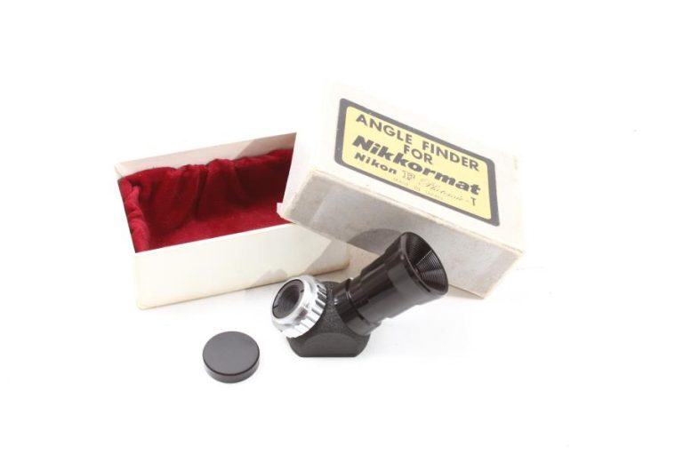

My girl friend gifted me one for my Nikkormat in the mid seventies. Still have it and the box. Lost the cap though. She also bought me the diopter but it got fungus in it.

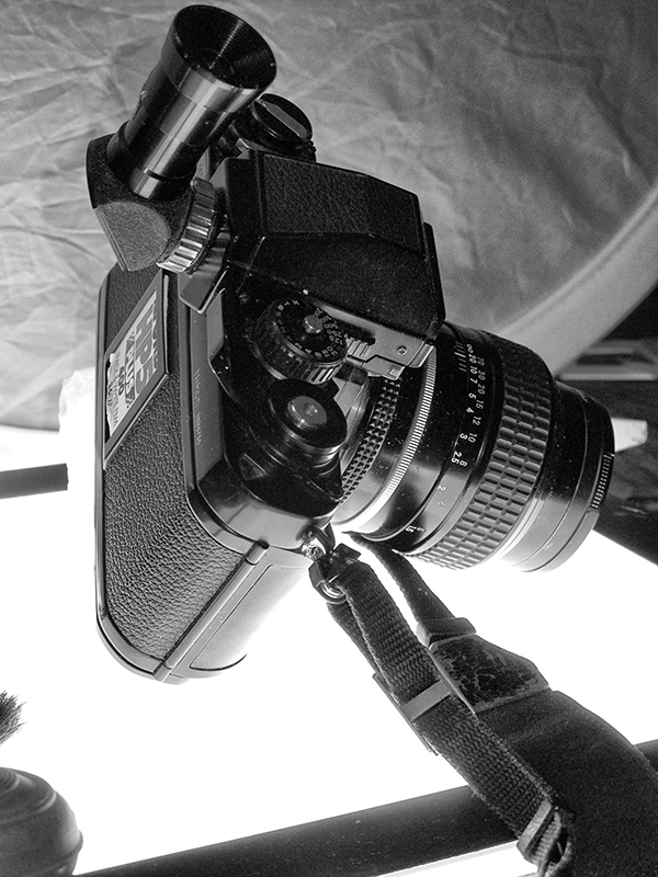

I mandatorily use one on my FM2n when in 90 degree copy stand mode. I wouldn't call this equivalent to a chimney hood, since there's a little bit of light loss due to the intervening prism and extra optics. But it can be a handy accessory to add to your kit. Mine looks like a later model than the posted picture, and has an integral but easily removable rubber eyecup. It's quite solid unless you outright drop a camera or something like that.
Whoever that Nikon "guru" was doesn't win my endorsement. I'd like to see him operate a tall copy stand without one. Or, if you're way low to the ground or studio table surface doing an insect shoot etc, or have an extra long microscope adapter tube. But no, I wouldn't attach a camera strap to the angle finder and go shoot a football game or street riot. Just common sense, really.

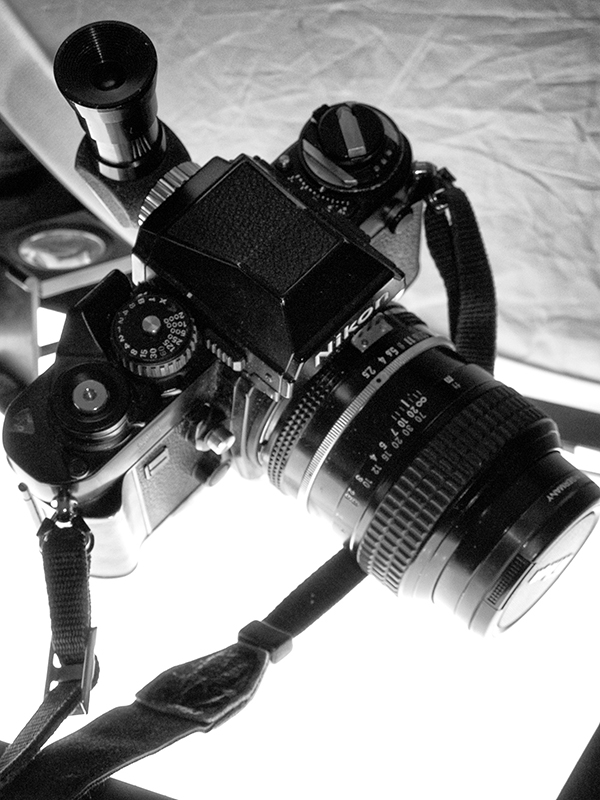

My gifted Nikon Rt Angle Finder (1974?) attached to my current Nikon F3, non-HP. Capture taken with my Canon PwrShot G10.
