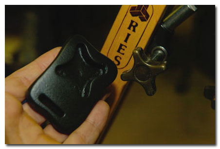

I really love my Ries, but the forward/backward adjustment knob likes to mess with my fingers. When you have a lot of bellows out you have to tighten that sucker up good and it hurts my fingers when I loosen it. A little leverage was what I needed so after a few nights out in my shop I came up with this key. It works really well and makes working with gloves on a lot easier too.
PIC 1
Here it is on the offending knob. Notice the knob is a little chewed from being encased in resin to make my first block of resin that would later become my master.
PIC 2
Front view.
PIC 3

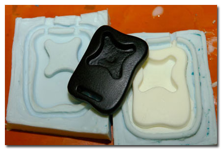

A shot of my mold. The white piece is how it looks when it comes out of the mold. At this stage it still needs to have the flashing cleaned off and some minor sanding. A lanyard hole also needs to be milled or drilled out. The black version is a cleaned up piece with 4 coats of a rubber tool dip applied which gave it a good finish.

It would be great to see step by step instructions and pics. Did you degass the liquid for the mold? What material did you use for the final piece?
Looks like you did a nice job.
