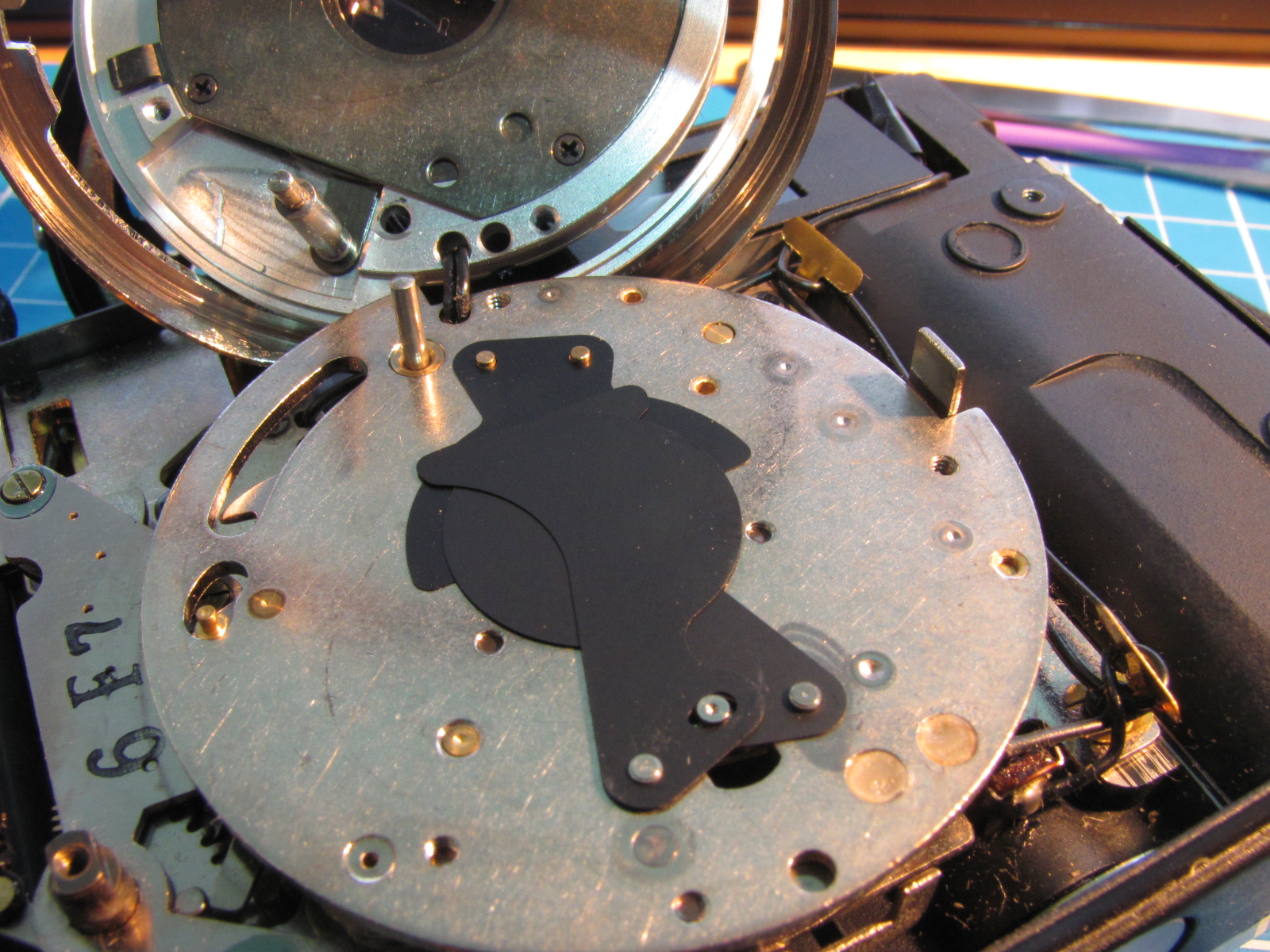

2. I've taken it apart from the front and need to get the shutter blades back in the correct order. The two moving blades I've more or less figured out, but I'm not sure of their order, nor how the stationary semicircular blade at the top fits into the order. I'm guessing top then right then left (anchor points), but I'd like to confirm that with a definitive source.
3. I was opening it up in order to fix a sluggish automatic aperture diaphragm (aperture opens correctly, just seems to get stuck a bit when half open), so any tips on fixing that would be much appreciated. It looks like lubricating the aperture unit (in front of the shutter blades) with graphite might do the trick, but again, would be good to confirm.
So far my internet searchings have turned up a lot of people asking for a repair manual but no repair manuals - anyone know if there even is a repair manual for this camera?
Indeed! Well, I have photos from when I was taking it apart.
This one shows the parts in what i think is the WRONG order. Included because it shows the shape of the top semicircle part well. The top semicircle part doesn't seem to move.

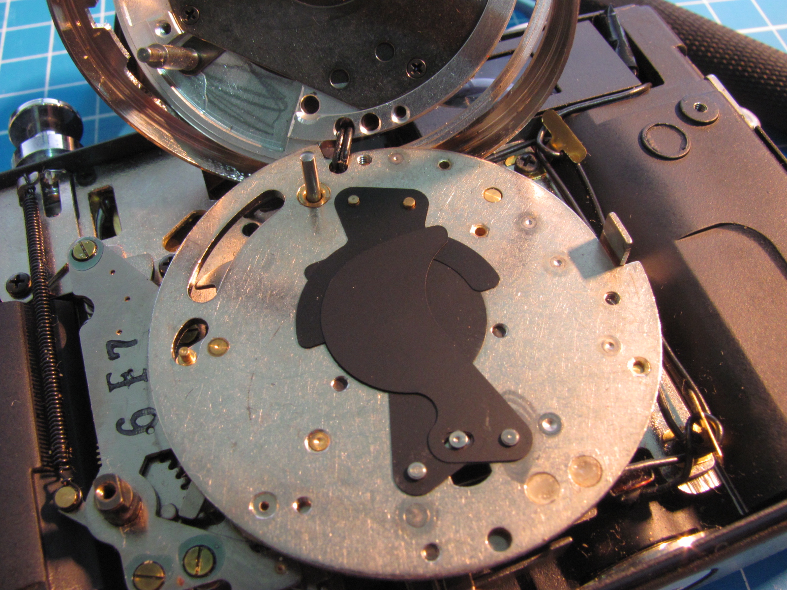

This one shows the parts in what I think might be the right order. Reason: there's a metal spacer that links the right blade anchor (for the blade that moves to the left of the light path), so if the semicircular non-moving part is positioned below the blades, the right blade is not on an angle.
But I'm not sure, because the blades fell out before I saw them in place. Confirmation, whether theoretical or actual, would be great.
Edit: the other alternative could be that the top semicircle might go above the blades to keep them away from the aperture module. Or between the blades to minimise friction.

Hey there, old thread, but I want to provide the answer I found for future people who stumble across this.
I used an AI translator on the Japanese video above. At about 7:30 we learn that the top shutter piece is designed to separate the shutter blades to reduce friction. So yup, in the middle!
