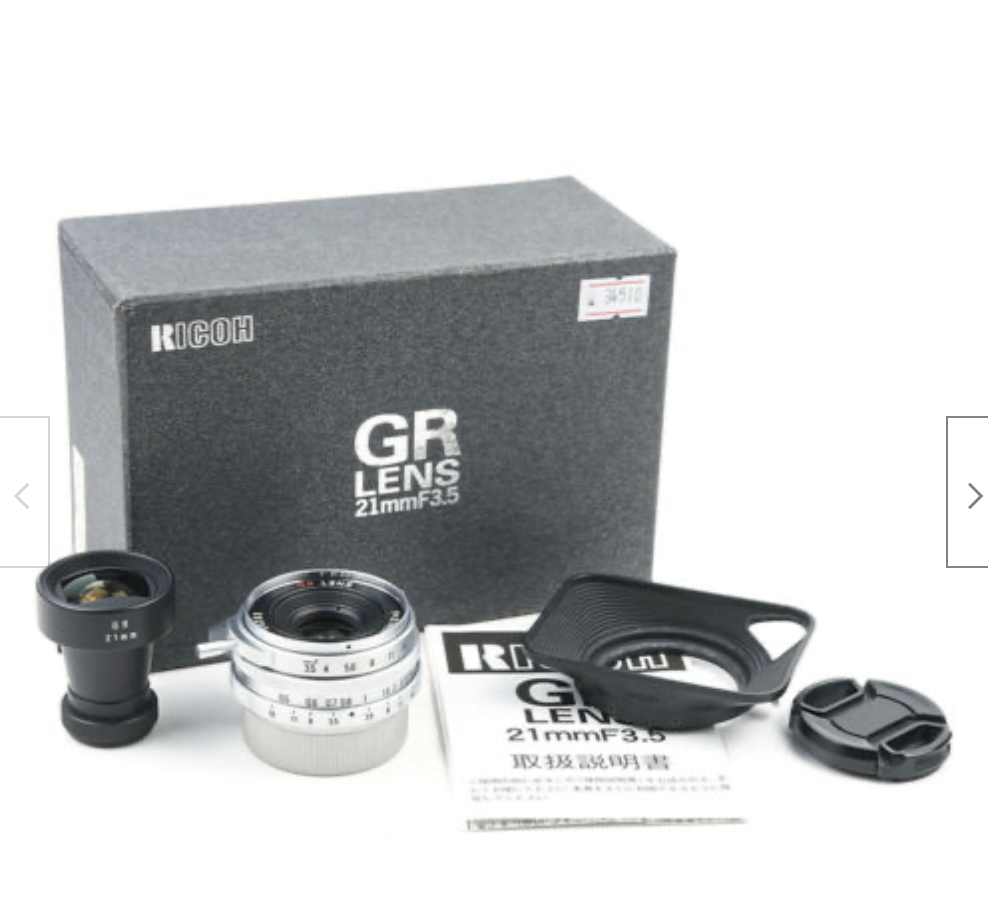

Wondering if anyone has experience with this combination and can confirm that it works without issue?
My favorite 21 is the Leitz Super Angulon f3.4 but my understanding is that the lens cannot be used on a Bessa body because the rear element will interfere with the shutter mechanism in the camera. I don’t love using an external finder on my M body so that’s where I started thinking about one of the Bessa bodies with 21mm frame lines. I’m a fan of the Ricoh 21 so am now wondering if this lens will work on an R4M or R4A without the issues presented with the Super Angulon.
If you know about the combination please let me know. Thanks very much.

Can anyone speak specifically to the compatibility of the Ricoh GR 21mm f3.5 (LTM) lens on the R4M or R4A via M adapter? Does the meter work? Does the lens interfere with the shutter? Etc.

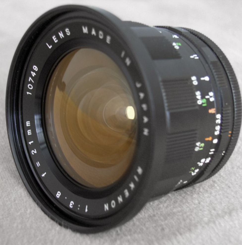

I may have misinterpreted you first post. I thought you were seeking a lens that won't interfere with the shutter of the Bessa.
I'm not familiar with the Ricoh 21/3.5 so I looked it up and it is not what I thought. I thought it was the 21/3.8 you were trying to fit on the Bessa.

Yea, I’m talking about the Ricoh GR21 lens. Same lens that is on the point and shoot Ricoh GR21, made in small numbers in Leica mount. Incredible lens with very unique rendering. I like it a lot (although I still love the Super Angulon above all other 21’s).
I dug in a little deeper and found one reference on Flickr of someone who used the Ricoh on an R4M so I think it works so I may try it it. I may also give the Color Skopar another shot. It is a good lens no doubt but I’ve never been enamored with its rendering like the others although it’s neutrality could certainly be seen as a positive.

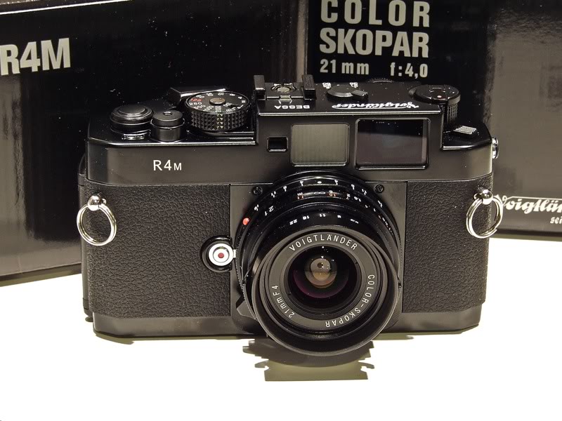

That Ricoh lens looks smaller than the Color Skopar so I think the viewfinder image should be ok. The Bessa has TTL metering from the shutter curtain with a center weighted pattern which seems to work well with a 21mm.

Yea, I’m not overly concerned with viewfinder blockage. I don’t have a Bessa on hand anymore but my experience with them was that viewfinder blockage wasn’t much more noticeable than on my Leica M bodies (with my preferred lenses). And as ic-racer mentioned, the Ricoh lens is small (much smaller than the Super Angulon which has always been my preferred 21 and was never an issue (it blocks part of the finder but you get used to “seeing past it” very easily).
I haven’t extensively tested the meter in the R4M or R4A so that’s good to think about but I’ve only heard of issues when the rear element of the lens protrudes too far into the camera and messes up meter readings. That’s one of the things I’ve been wondering about and trying to get answered about the Ricoh lens but again it’s rear element protrudes less than the SA so hopefully not an issue.
As to viewfinder, I’m specifically interested in the R4M and R4A because they have 21 frame lines eliminating the need for a top mounted finder. That’s my main reason for thinking about this above all else.
