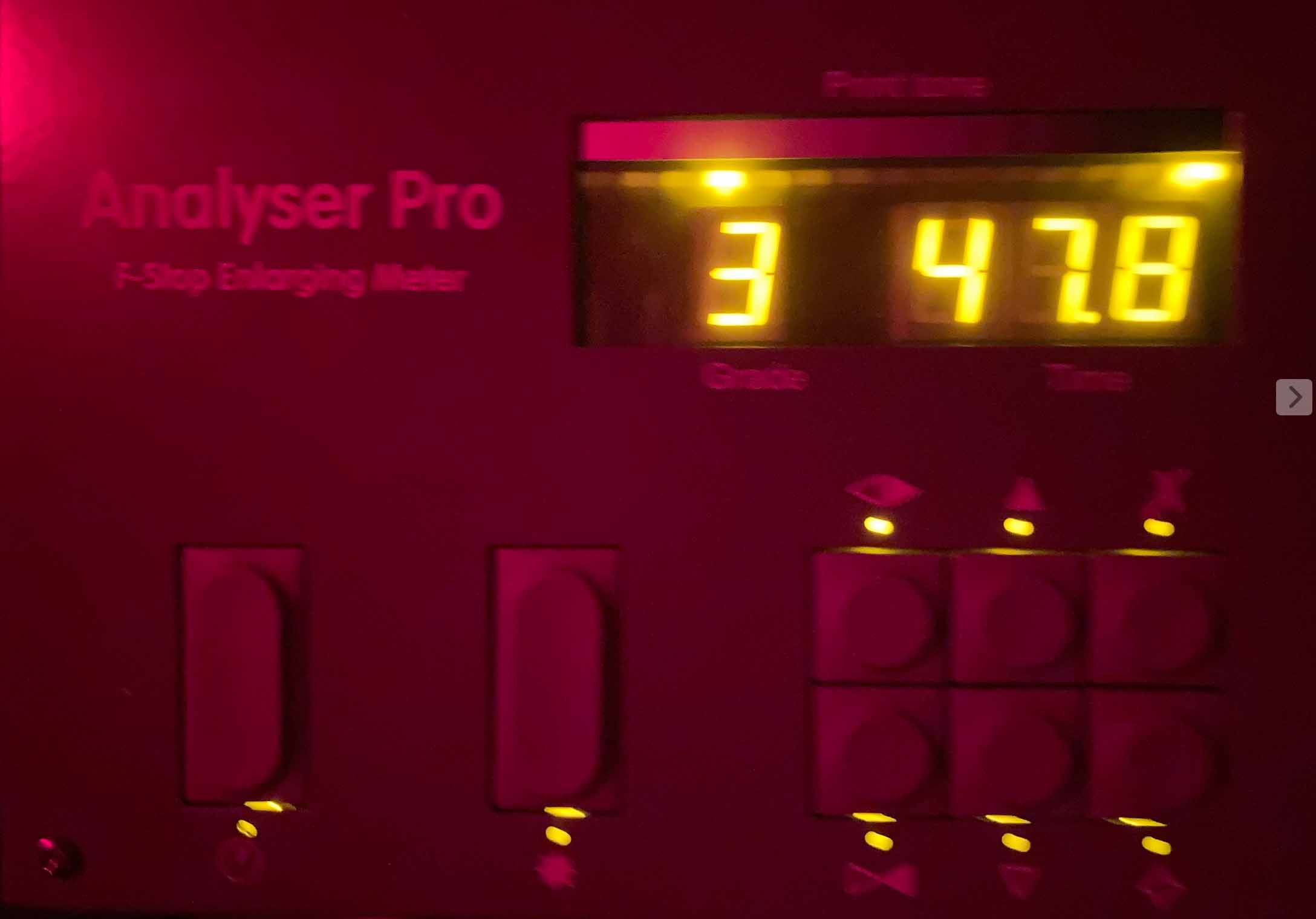

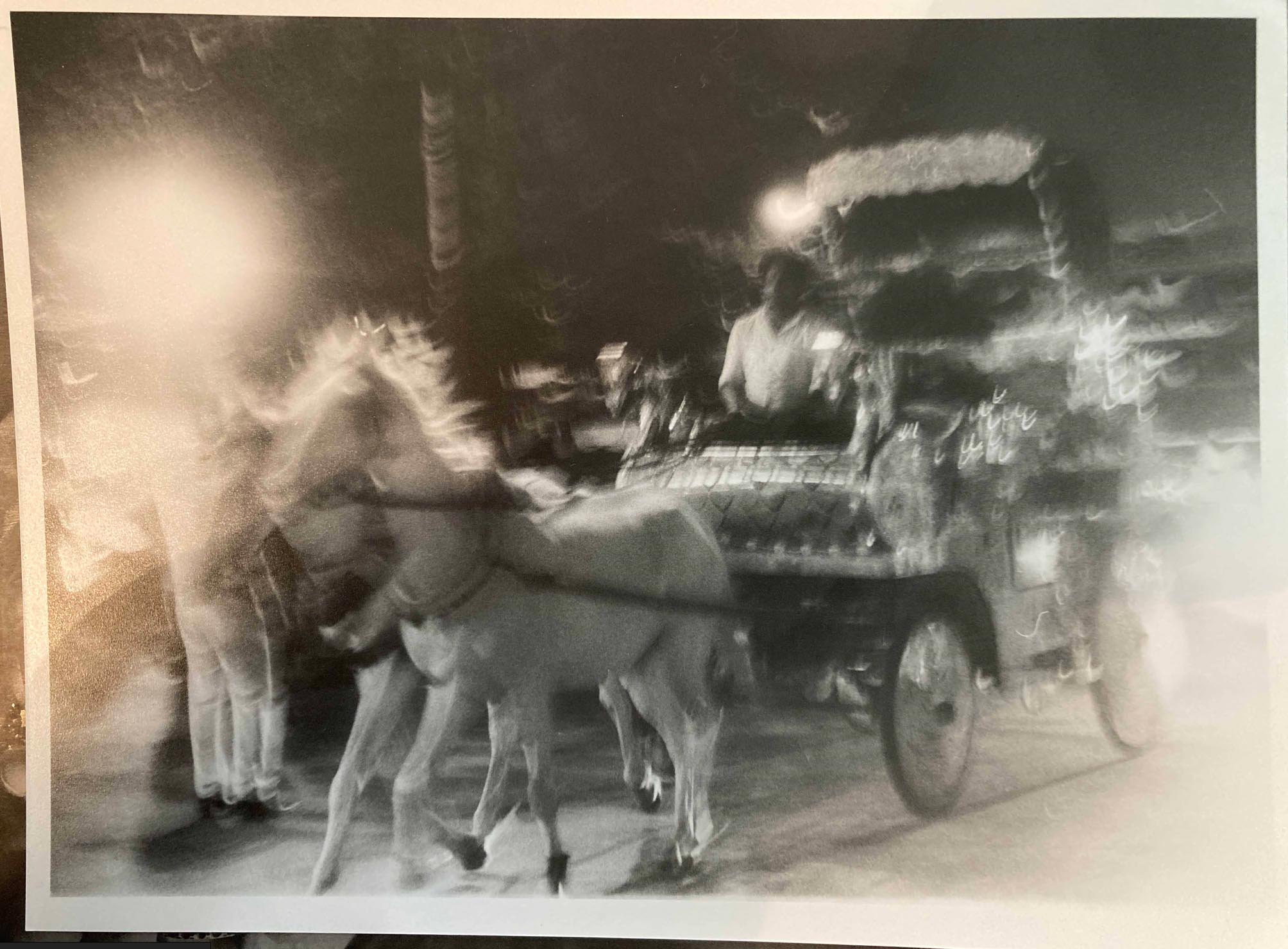

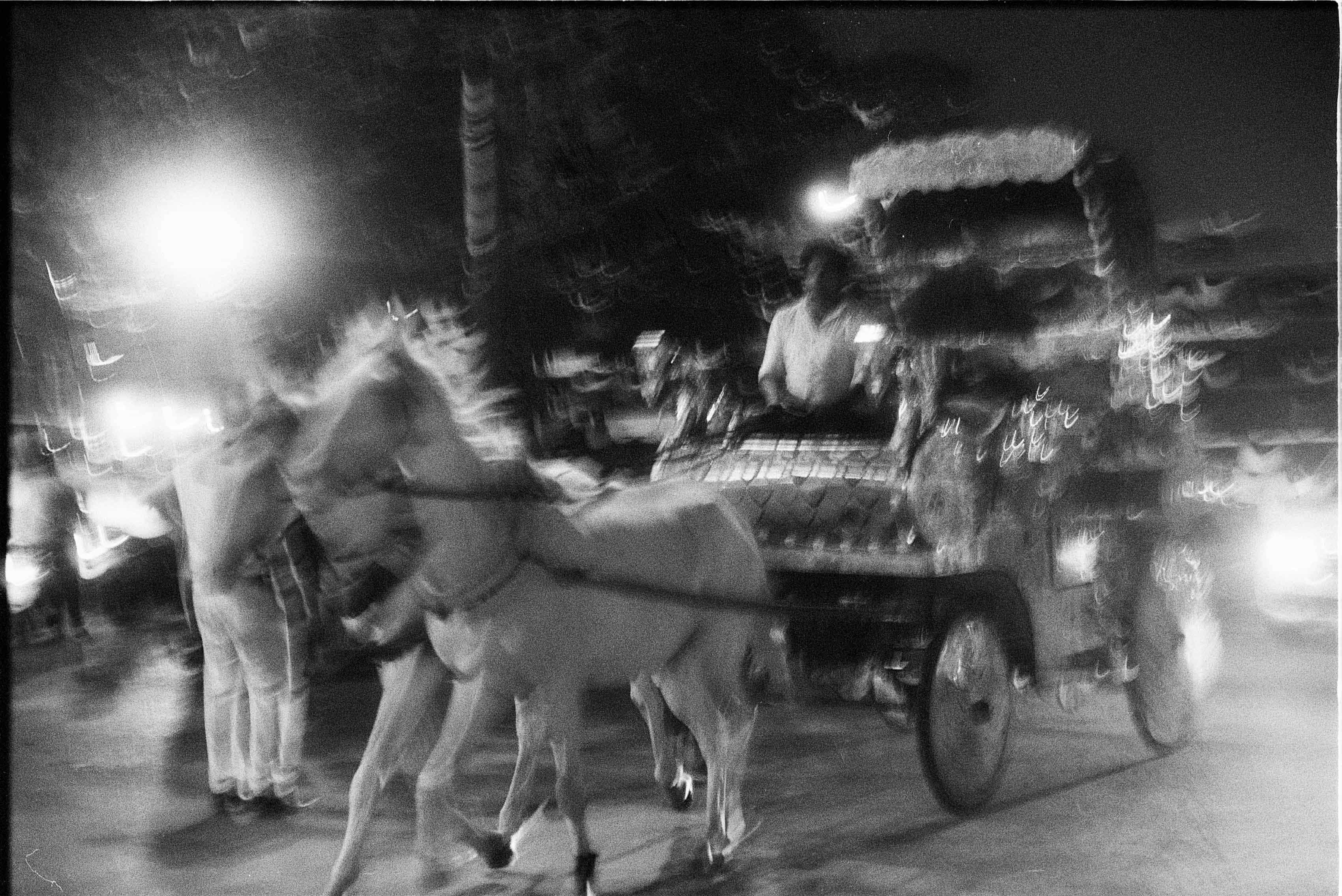

I' m having difficulties finding the right spots for metering the highlights and the dark tones with the Analyser.
Just made a print. 47.8 seconds on grade 3. I had token the highlights on the horse under the belt, and the dark tones in the upper region (middle) of the image. To my surprise it did give me a relative big tonal range, contrary to the first image.( more then 10 steps). I then increased contrast. But the print was almost completely black.
Could you give me some advice on finding the right metering spots? I find it very hard to find a spot with detail ; since most of is blurred.

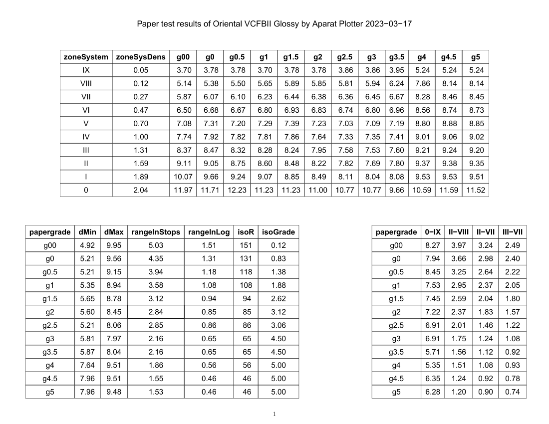

This is a very interesting question and challenge for printing systems that rely on reading light levels projected onto t he easel. You will probably not like my answer, but, before you can benefit from such a system, you need to thoroughly test your materials, film and paper, though in this case, paper testing is more important. Then, you will be able to establish the important (to you) ranges of exposure and contrast. Here's an example of the kind of useful data you can produce. This can be used to program a more sophisticated timer to automate the process even further. I am not sure how your timer works with custom programming. Edit: I uploaded the wrong chart. This one is for the newer Oriental paper:
These charts will then guide you to make decisions regarding choosing the right paper grade (filtration) and exposure, including all the necessary dodging and burning, because they are made specifically for you and your materials. The total work required takes about an hour, but the benefits can be significant. I cannot describe the process in a short forum post, but I encourage you to read Way Beyond Monochrome, Beyond the Zone System, and all the awesome documentation provided on the Darkroom Automation website. You should be able to use your existing timer/analyzer with whatever paper exposure system you choose. They are all very similar, though the details do vary.

I am back with some good results. I had a wonderful print with the following settings.
Grade 4 / 29 seconds and F/16 lens aperture.
The dark tones are nice black. So it was possible with a blurred image to start from, without much detail.
