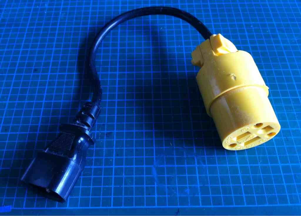

If the 2 prong plug on the Aristo is not polarized (one blade bigger than the other) then it doesn't matter which is connected to the live and the neutral. If it is polarized, the wire going to the wide blade is neutral. If you don't want to rewire, go to a hardware store and get the parts to make an adapter like the one attached. What's not to be happy about - RH provided the IEC connectors!

Looks like it is not polarized, so I will go that route. I am pleased as punch to have the product, have a Processmaster II on order, paper flasher. I just like knowing what all I need before things arrive.
I would PM Richard, but the time zone difference brings a delay into it all and unfortunately, I have a couple print deadlines to make, already removed the old sensor from the head..
**update**
Wired it, plugged in, nothing blew up. I am sitting on the couch with a glass of wine programming it, checking it all out, so far, so good.
