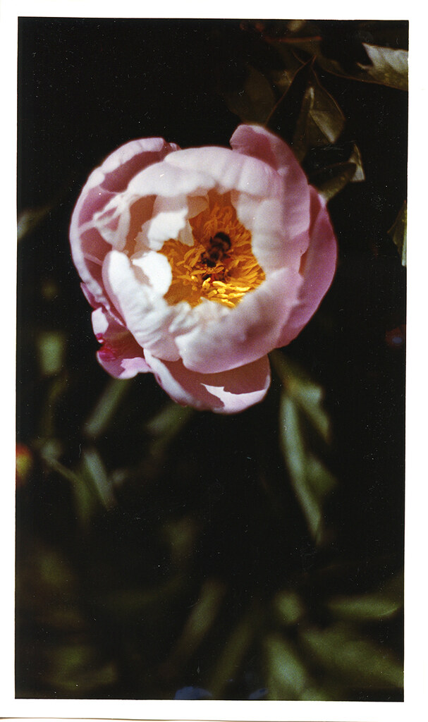

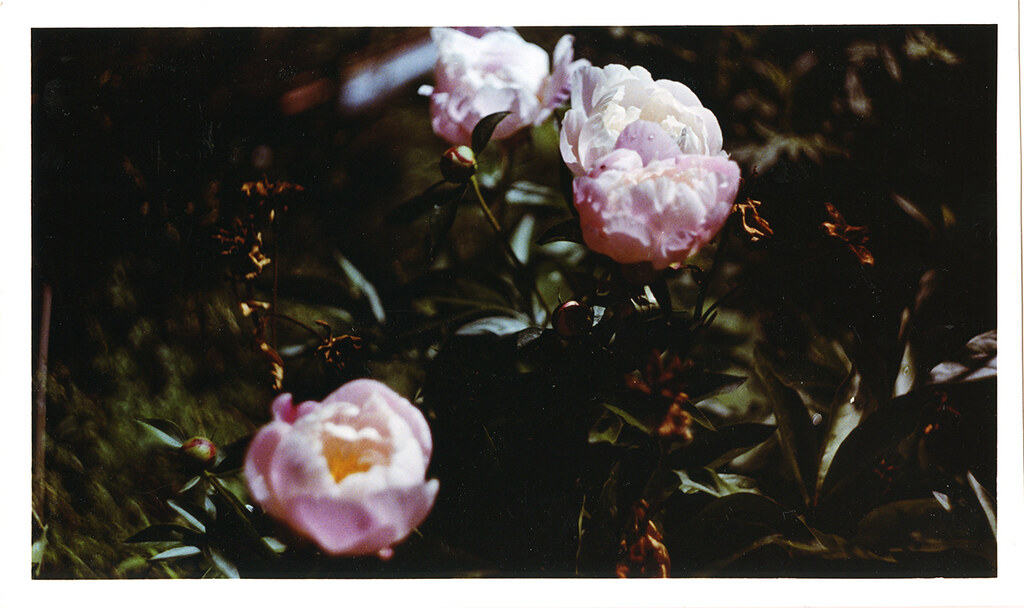

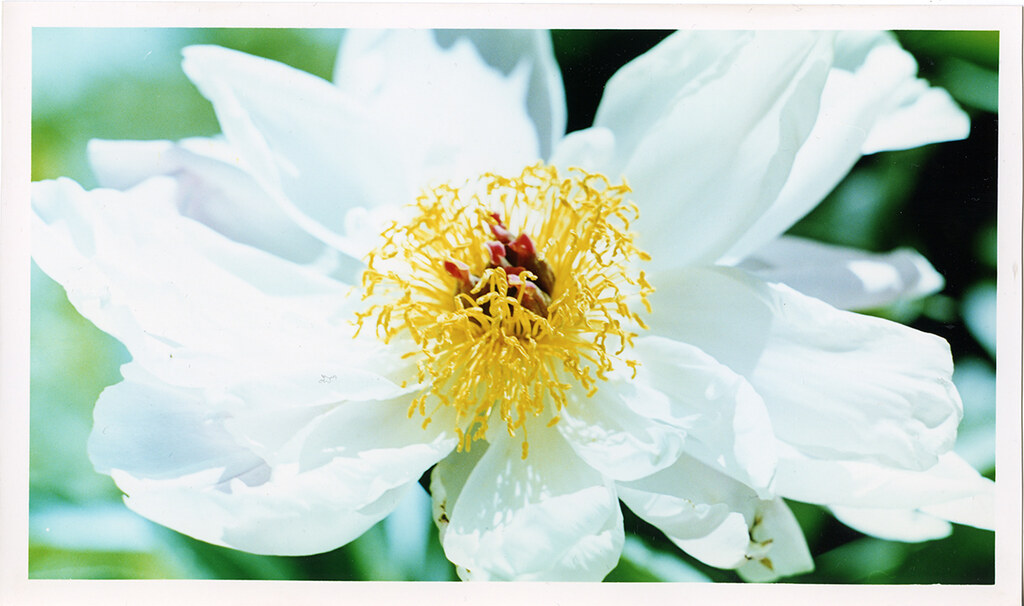

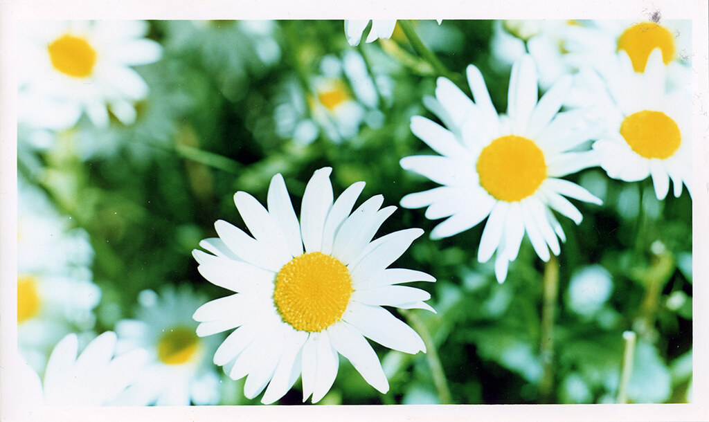

I do not currently have a color checker. I've been using photoshop to analyze color and have done some tweaking to my printing. There was some inconsistent lighting due to a defect either in the enlarger or the shape of the bulb, causing a color cast on peripheral parts of the image. Bandaid solution was to adjust position a little and stage the negative farther from the light source. Still looking for a solution but I have done some tweaking and obtained fairly neutral results without a color cast that I am very pleased with. Criticism is very welcome:
Portra 400 on Endura print 2 by Aaron, on Flickr
Gold 200 on Endura print 2 by Aaron, on Flickr
Gold 200 Endura print 1 by Aaron, on Flickr
Thankyou! :smile: It's rewarding to finally be getting good prints at home without a computer. Hope to post more results soon.
