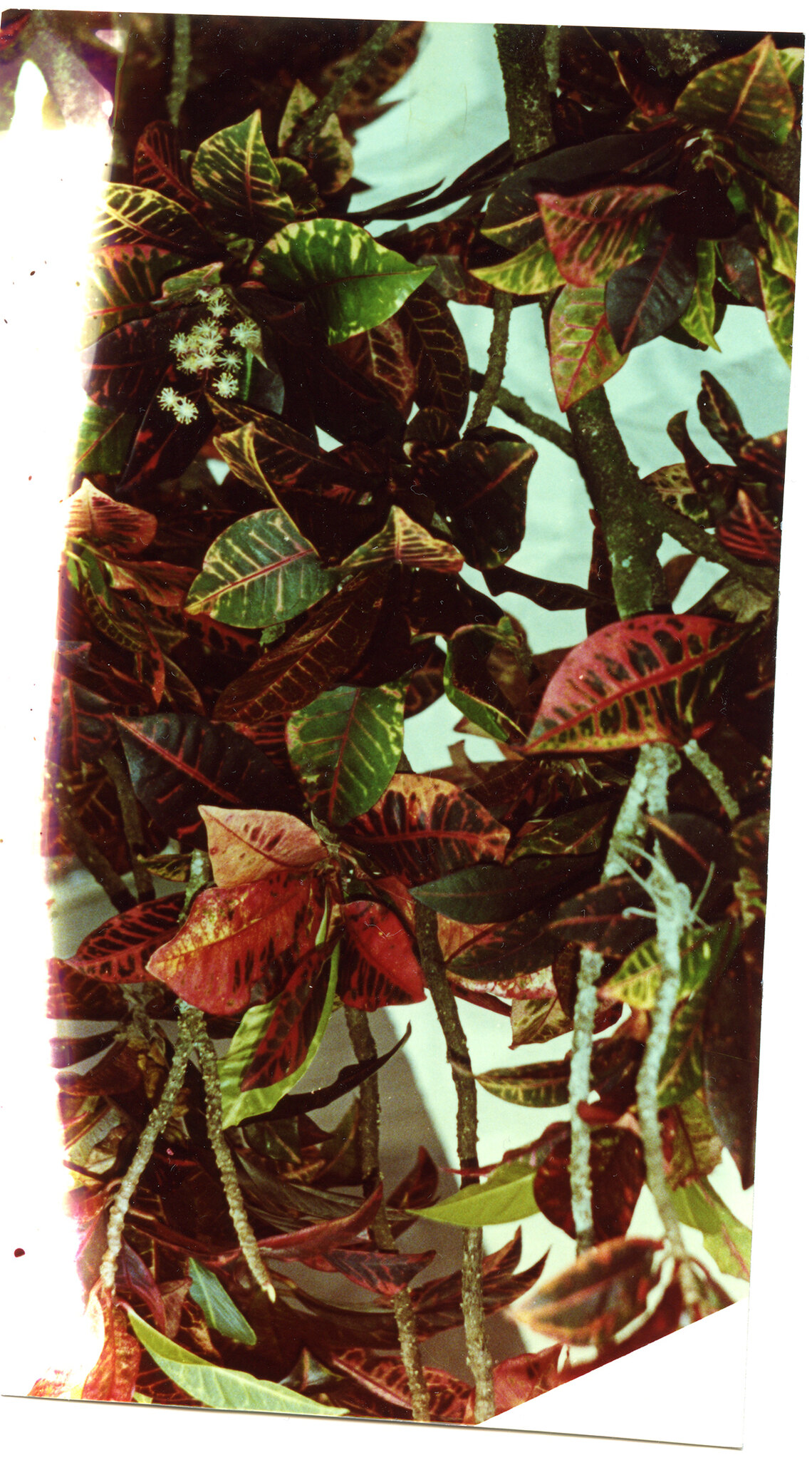

Alright, so I printed a few test strips on Endura just to give you an idea of color, waiting for them to dry. One of Portra 400 and the other Portra 160 using the filtration settings for Portra 400 (331degrees hue, 41% saturation). They seem to match, but more tests are needed. So far I have nailed Portra 400 and Kodak Gold 200 on Endura. Overexposed images use similar hues but require more saturation to cut through the mask. Currently waiting for these to dry.
First image is one of the first I printed with LIFX, ektar on fuji CAII lustre finish. The filtration isn't tweaked 100%, it's a little too saturated. I started printing on endura shortly after and ditched CA before bothering to get it perfect. Had to discover new settings. But the hue (zero degrees, I think 50% saturation) is correct. So maybe 45% saturation would work. When you nail hue, Less saturation gives warmer colors and more saturation gives colder colors. It's fairly intuitive compared to CMY or RGB when you get the hang of it. Anyways straight scan:
Ektar-CAII-Test by Aaron, on Flickr
I think Fuji CA-II may be better for ektar as endura has stronger contrast.
Here it is with color balance shifted warmer in PS, just to prove that the colors are technically 'there'
Ektar-CAII-Test2 by Aaron, on Flickr
1kgcoffee
Jan 19, 2017
500
Calgary
As promised, here are the two test strips:
35mm Portra 160, printed with settings for Portra 400
Portra160-Endura by Aaron, on Flickr
6x6 Portra 400
Portra400-Endura by Aaron, on Flickr
I have not done extensive testing with Portra 160, but it seems to be very similar in setting to 400 as you would expect.

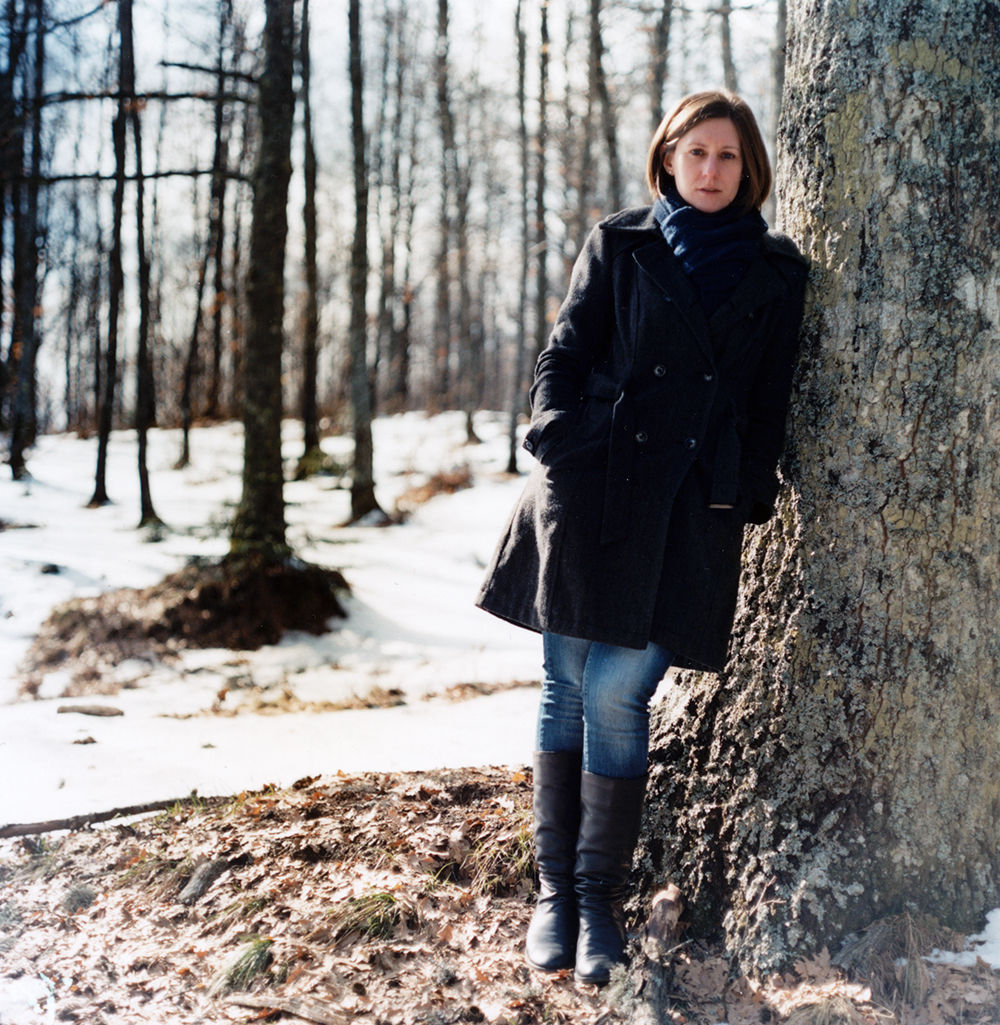

So modern RA-4 papers do work with old style enlargers,
I print on Kodak endura premier, Kodak DIGITAL premier and fujicolor DPII paper with no issues on my halogen light enlarger. Not sure what you are talking about. This is a print from portra 160 on Fujicolor DPII
