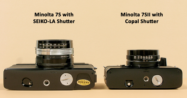

There are several fixed lens rangefinder cameras that have a "paddle" on the bottom of the lens for fast, easy focusing -- quickly moved by your finger. Here's the one on the Minolta 7SII:

I used a Canonet QL17 GIII for a few years as my daily carry camera. It used the paddle style focus listed above and I thought it was very quick focusing (for a m/f camera).
