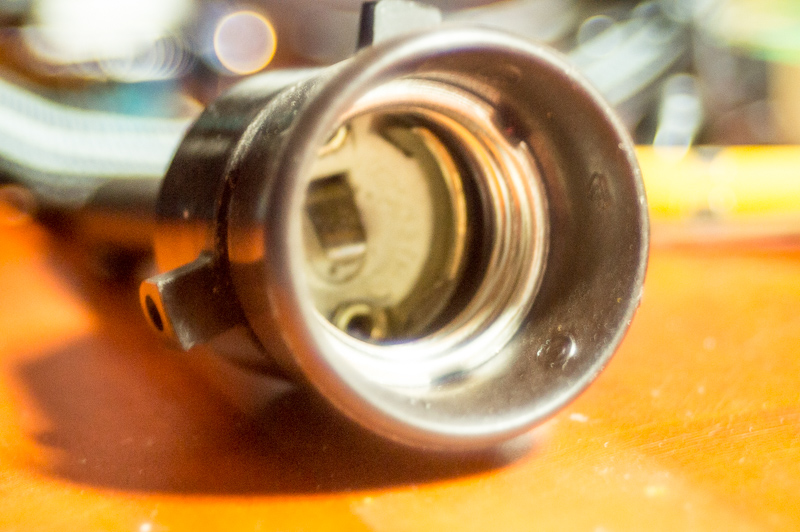

I recently picked up a Focomat 1a that needed some attention and I am getting around to it this weekend. It of course had some bad wiring. I took apart the lamphousing and managed to find all the springs afterwards (oops) but I am stuck at getting the socket apart so I can rewire it. Anyone know how this thing comes apart? Any help would be much appreciated. It is a 1a and not a 1c but the date on the lens puts it at 1949. Here is the socket-
I do not know this one.
But typically german Edison fixtures of that size have a blocking lever inside the thread.
A brass lever sticking out from the base plate arrests in a ratchet-manner at ribs of the outer Bakelite ring.
Just bend that lever back during one turn or so and you can further twist off that ring without a problem.
Got it! It just screws off. Duh! I didn't see the join between the two halves because of dirt so I thought it was one molded piece. That is my excuse and I am sticking to it.
Here it is apart for posterity-
attachment.php
No excuse accepted... I even could take them apart when I was a child and there was no Apug around...
But I guess we grown-ups lack imagination.
