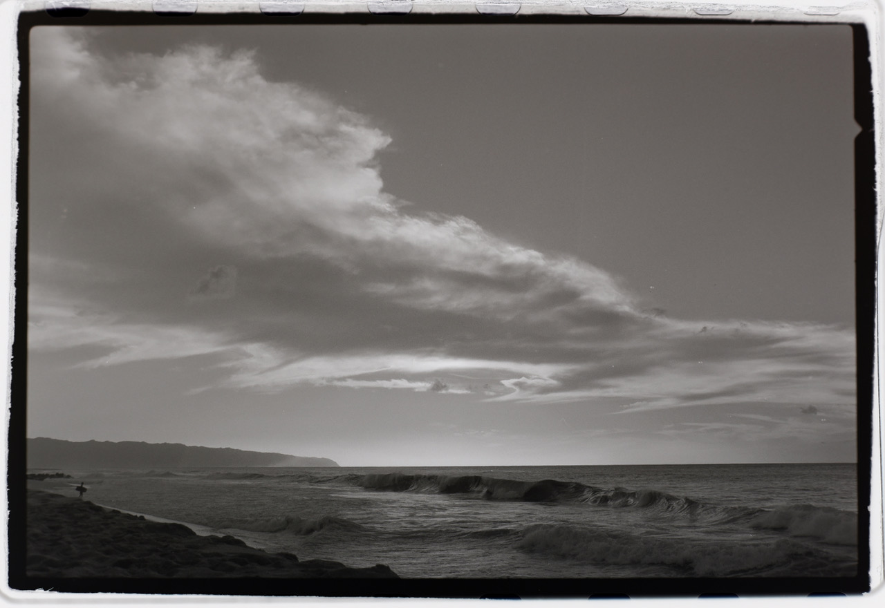

Just a quick post to update; Acros ll in Microphen 1:1, 73.5->74.5F, 8 minutes. Recommended time was 11 minutes at 68, corrected down to 8 as per Ilford time/temp table. Agitation was full first 30 seconds, then 5 agitations at the start of 1 min, 1:30, 2 minutes, then at 3 minutes, 5 minutes, 7:30 minutes, pour at 8. Upon review, some in camera exposures were a bit under (no meter on the F2) and my conclusion was that for this roll I could have extended the development about 10% and still be happy.
Image shot with a Nikkor 35mm f/2.8 Ai 6 element/6 group on the North Shore of Oahu. The light haze next to the mountain range in the distance is extreme salt spray from the powerful surf.
If I was wet printing this negative I would add 1/2 grade of contrast to the lower part and then burn the sky 10% or so with a 1/2 grade lower. My scan set up is compromised, but grain is tight and mild.
You may note the notch in the upper right side; I got this well worn F2 in the early days of the E'blay and it was sent to Sover Wong for a full rebuild. He noted some custom high quality internal work on this F2, and the notch was a modification in order to keep track of the mechanical shutters and meter accuracy across many camera bodies.
Yes, the notch. Done this to all my Leicas so I can distinguish the negatives
