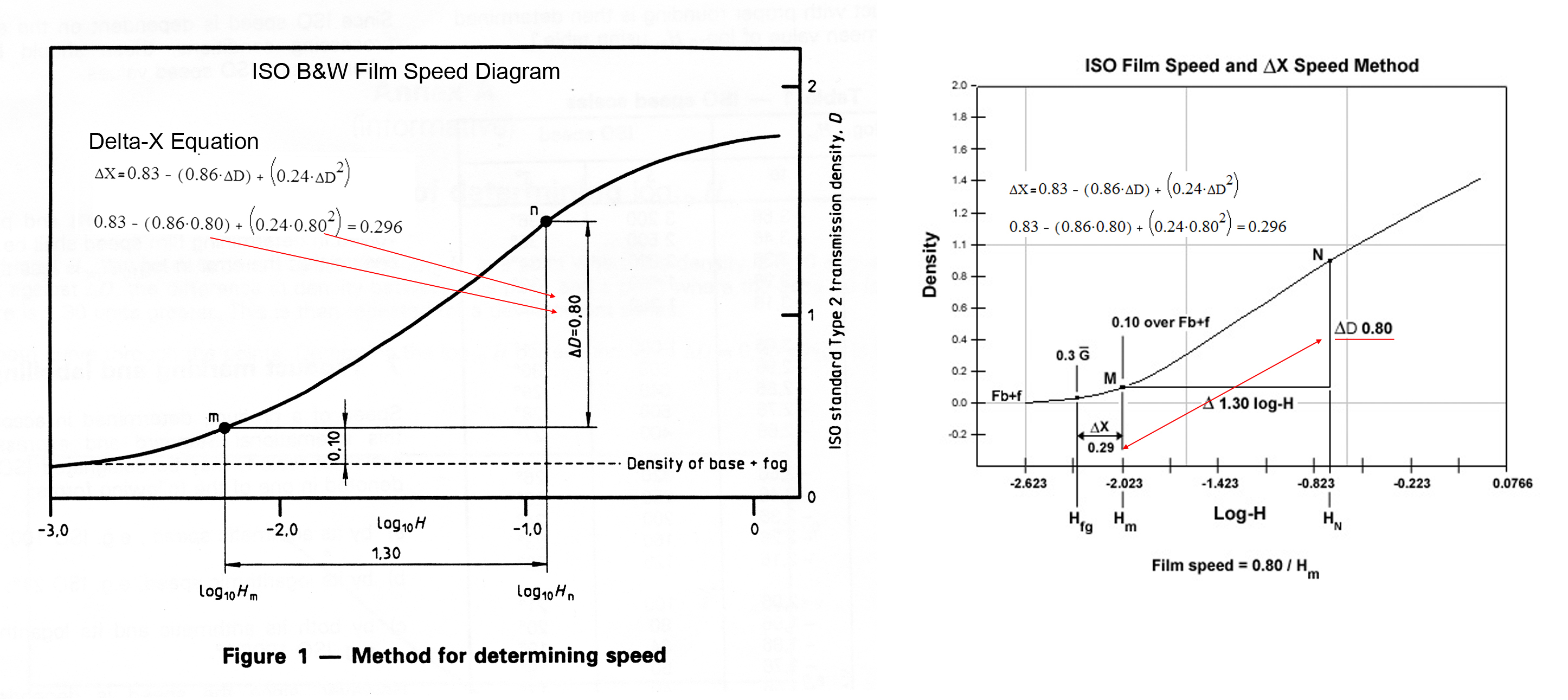

The Delta-X Criterion is a mathematical approach to approximate the same results as the fractional gradient method. It uses a fixed density of 0.10 over film base plus fog. The value of ΔX represents the difference between the fixed density point and the approximate fractional gradient point. It's value is dependent on the value of ΔD which is the density above 0.10 found Δ1.30 to the right of the fixed density point. When ΔD = 0.80, ΔX always equals 0.296. So when the ISO contrast parameters are followed (Figure 1) ΔX equals 0.296 and there is no need for the equation. Determining a speed value outside the ISO parameters requires the use of the equation or a look-up table.

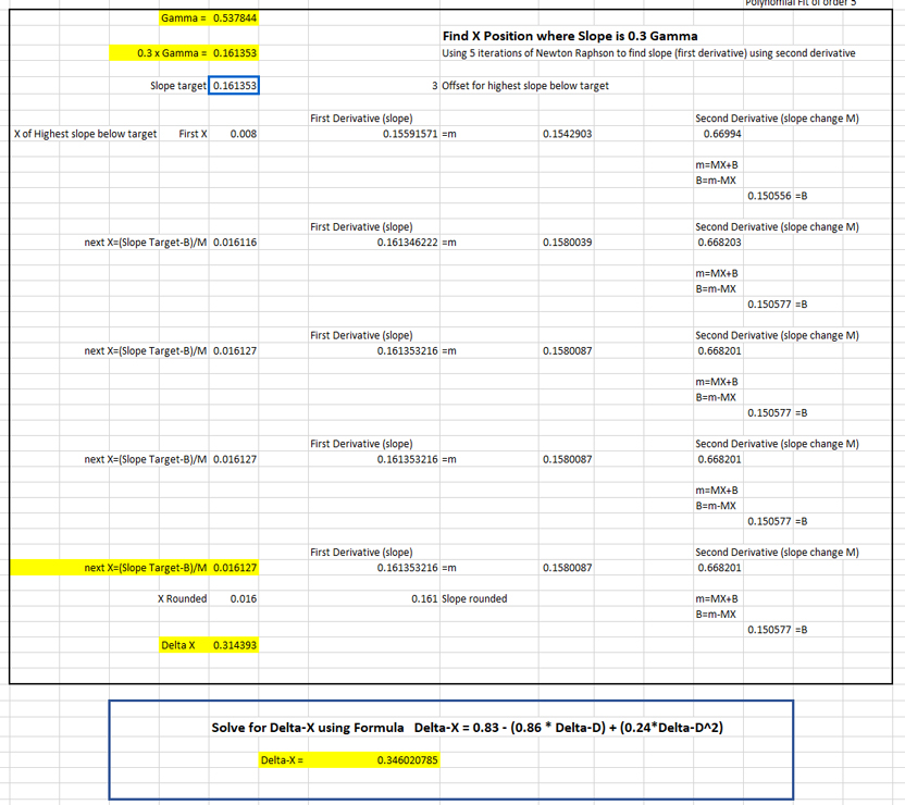

Thanks for that info about the delta x calculation. I don't understand how it was derived, but I've added that to the analysis file I've created. I'll post that shortly.

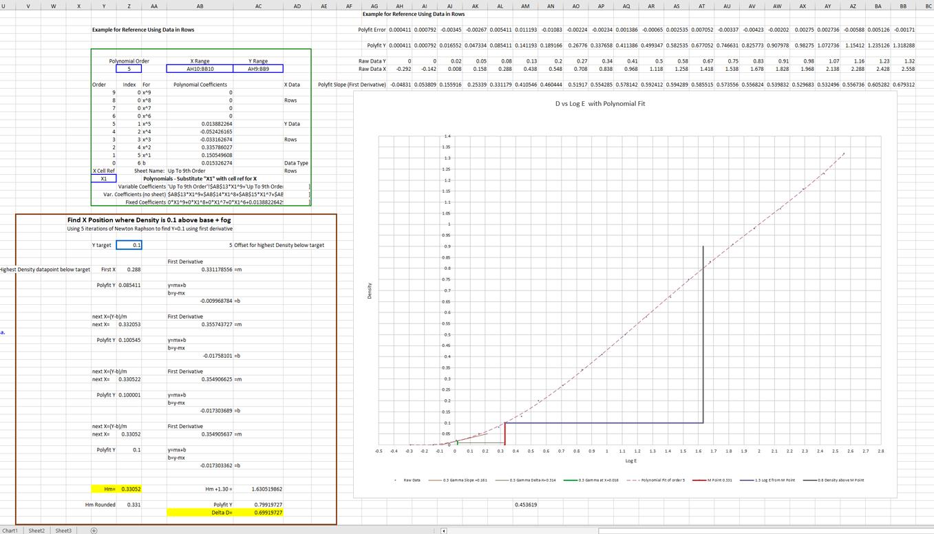

I'm showing a couple of images from the Excel program I created to create and graph a polynomial from raw data. The Excel file is also attached below. If you don't have Excel, you can download LibreOffice for free. LibreOffice has no problem with most Excel files, other than some minor formatting differences.
The original reason for creating the file was to analyze raw data using a simple representative function for the data. A polynomial is simple to use for analysis, and can represent some types of data very well. The characteristic curves for photographic film seem to work reasonably well with a higher order polynomial fit. In this particular case, it is well suited to find slopes at any point of the curve, since the slope at any point is the first derivative of the function. The first derivative of a polynomial is easy to calculate, as is the second derivative. This means that you can easily find the X position of any target slope (such as the 0.3 Gamma slope).
The basic form of a polynomial is aX^4 + bX^3 + cX^2 + dX + e (of fourth order). where a, b, c, d, and e are the coefficients of the polynomial
The first derivative is 4aX^3 + 3bX^2 + 2cX + d
The second derivative is 3*4aX^2 + 2*3bX +2c
Higher order polynomials are handled in a similar fashion, and it's simple and straightforward.
  • Polynomial fit for D Log E curves 4.xls
