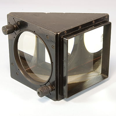

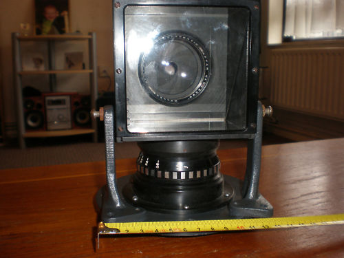

Some process lenses came with reversing mirrors. You could look for one of those.
johnielvis
May 21, 2010
966
that first one looks like it's big enough--like 10 inches? Great--where to find one of them==so "reversing mirror" instead of "reversing prism". simple enough. anybody know where they have a big pile of them?

I think you may have to make your own from a front-surface mirror. Look for an old junk photocopier, some of the early ones used great mirrors. I had a mirror from one that was about 9x14 inches.
But the reversing mirror assembly such as ic-racer showed you, is likely very rare. It's from an era when graphic arts was heavily film-based and where intermediates were carefully planned to be emulsion-to-emulsion for the necessary steps -- and the mirror assembly allowed one to break the rule. If you can find one, you will of course be set.

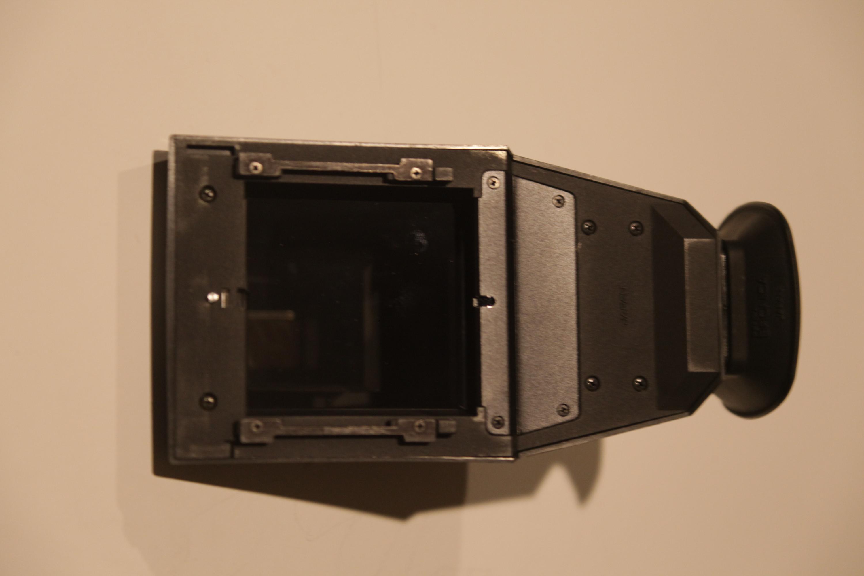

Yes--that's about the only conclusion to make--it's a DIY. New front surfact mirrors are pretty reasonable, it's just the mirror box--the construction of it--that's the problem. Maybe a job for Grimes, I guess. Alternatively maybe one of those 8x10 reflex viewers would work--those are probably more rare than the reversing mirror assemblies though.

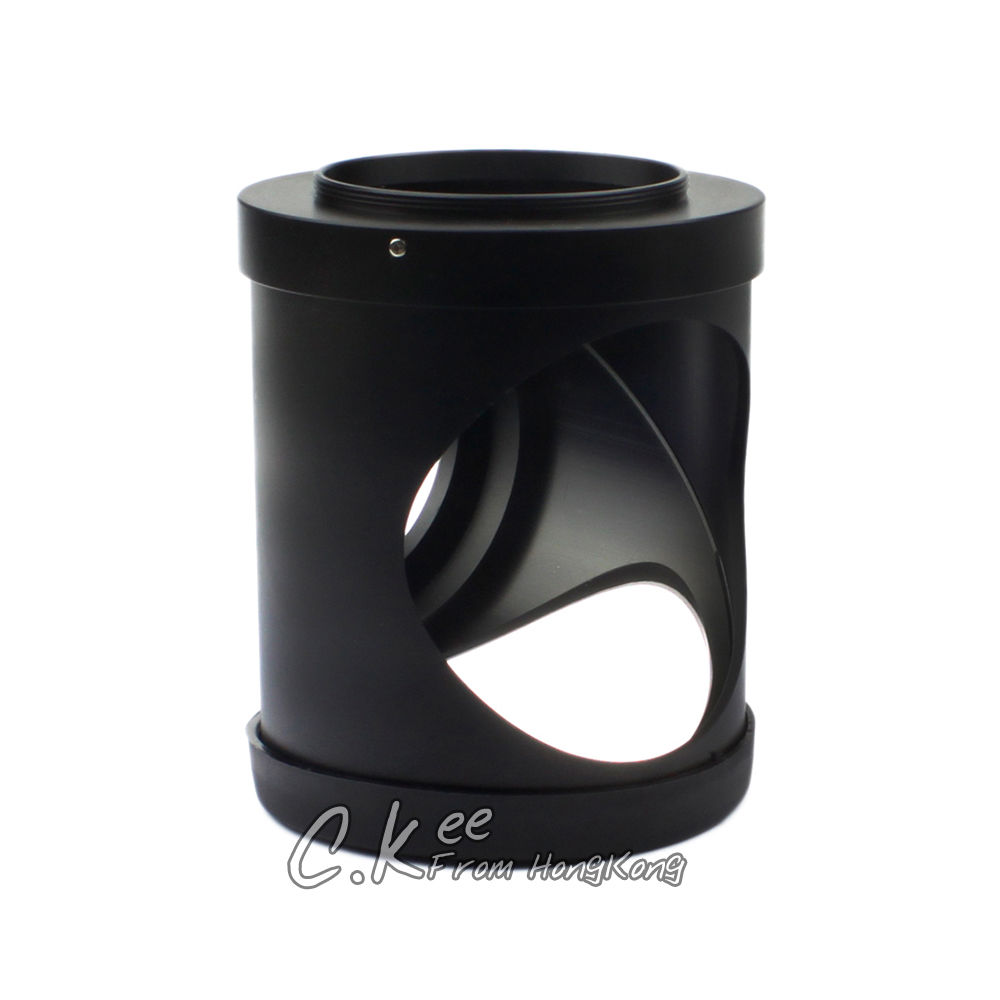

Something like this might work if you are using a long focus lens. You can buy these on ebay for $20.
johnielvis
May 21, 2010
966
that's what gave me the idea...them are too small even for 35mm...no chance for the monster lenses used--even overhead projector reflex boxes/mirrors are too small.

Some 4x5 cameras have (or had,) reflex viewers offered which may solve your problem. I believe that Toyo was one of them, if I'm not mistaken. I used to know a fellow who used such a viewer on an Ebony 4x5 to give a right-side-up corrected left-to-right image but I haven't seen him in years and don't know where his viewer came from. I see them come up for sale occasionally on Ebay.
Mike
Dan Fromm
Mar 23, 2005
6,886
so shooting pan paper as direct reversal also reverses (mirror image) the image like positive weplates.
Folks, this is the key part of the original post. What do viewers that clip on behind the ground glass have to do with it?
richard ide
Nov 8, 2005
1,217
Wellington C
They let you see what the image would have looked like if you had a mirror or erecting prism in front of the lens when you took the picture. :whistling:
johnielvis
May 21, 2010
966
GREAT LINK!--that was an idea--it may be the best idea actually--the most compact and most practical. special purpose camera for special purpose.
