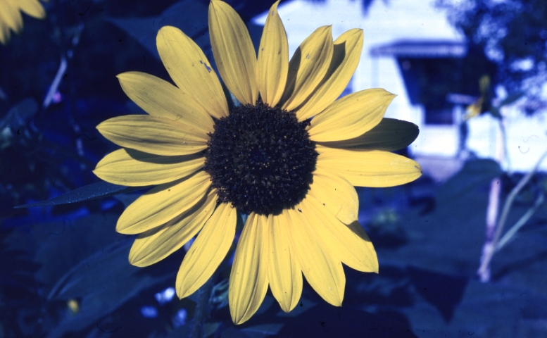

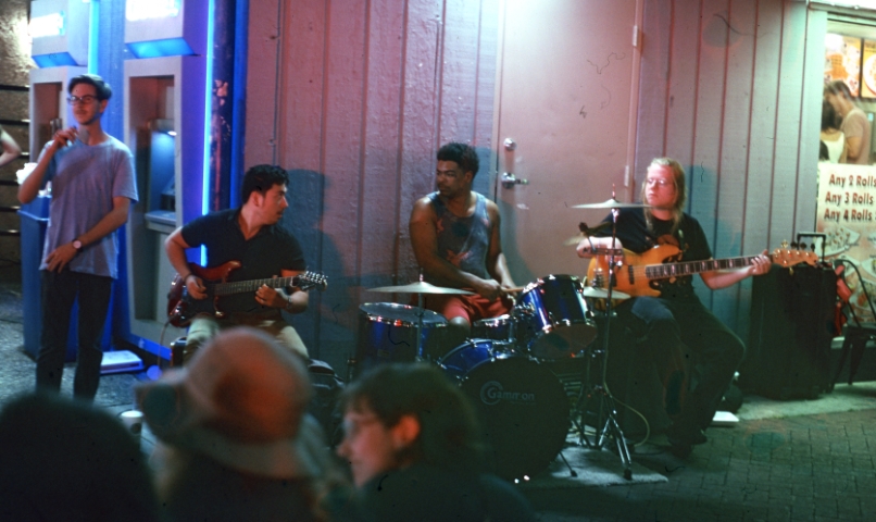

Yep, but not lately. It's not really suited to daylight but handles artificial lighting well enough. Green shadows though.
