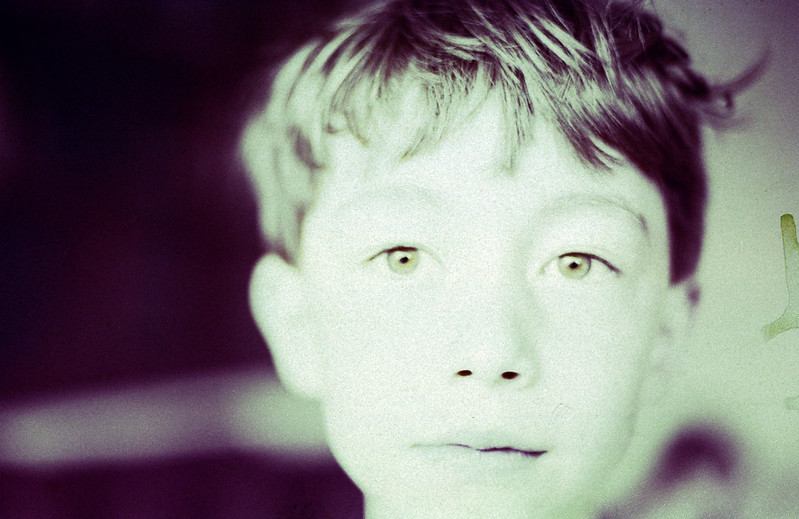

Ok so I reckoned given the enthusiasm with which I approached the re-exposure and c-41 dev, that it was likely the rodinal time was too long. I mean I know the first E6 dev is meant to be pretty hardcore, but I don't think I'd ever subject a B&W film to an hour and a half of rodinal at 1+50 at 40c whilst agitating continuously :-D
2nd batch got an hour, otherwise identical process, this was the result...
Ahhh. So we see, colours much better, highlights still blown though, and the borders are still pretty much see through.

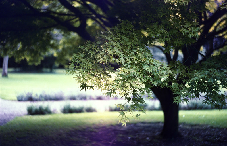

Much better, they actually LOOK like nice slides for a start when they come out of the tank, colours are ok, film borders almost opaque. I reckon it needs maybe just a smidgeon less, or next time I might try giving it 20 minutes with agitation and then let it sit for another 20 minutes with no agitation and see how it pans out.
End result : Qualified success :-D

@zehner21 it's a Helios 44-2, that rendering of OOF areas is pretty characteristic of it.
