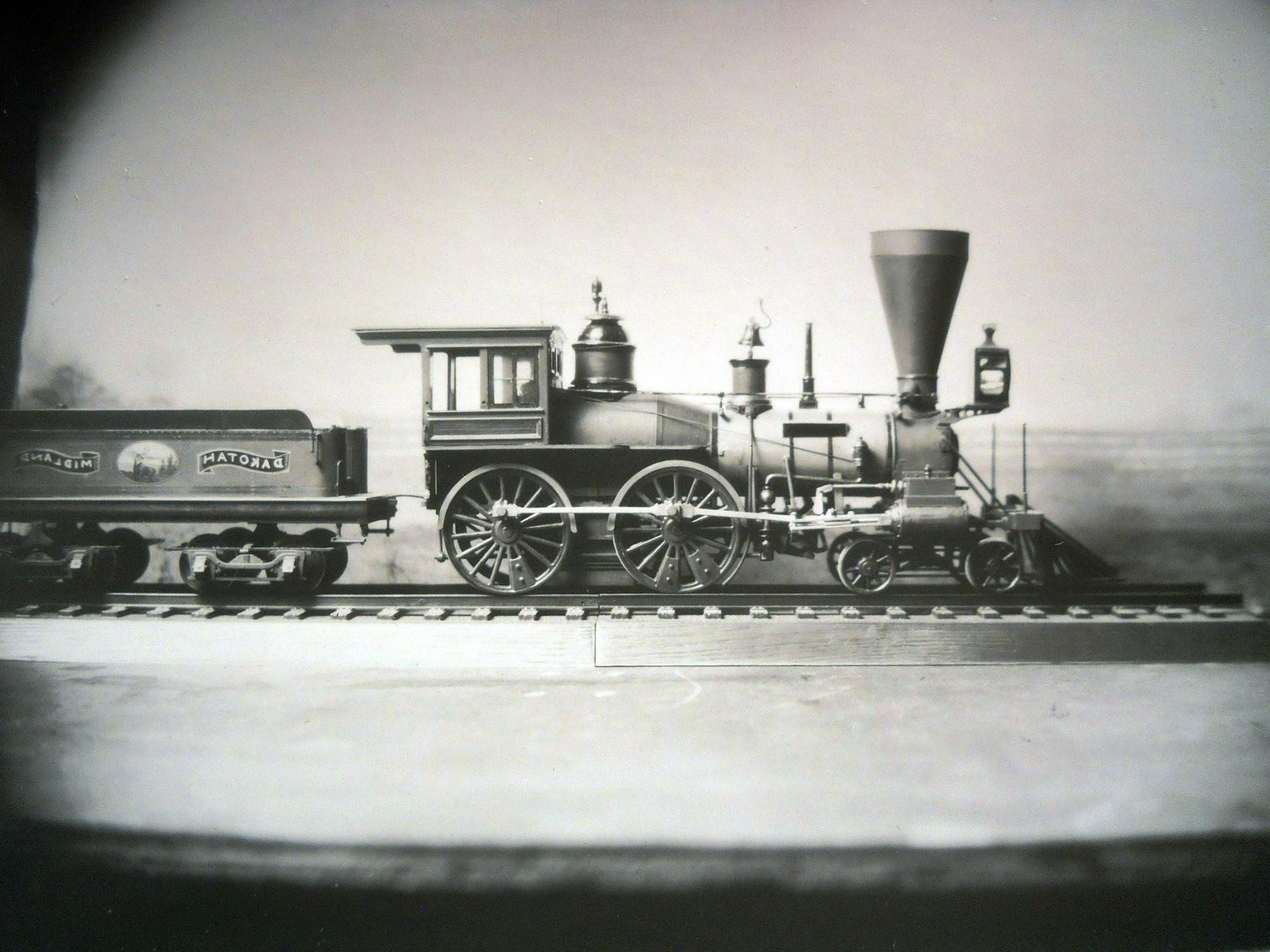

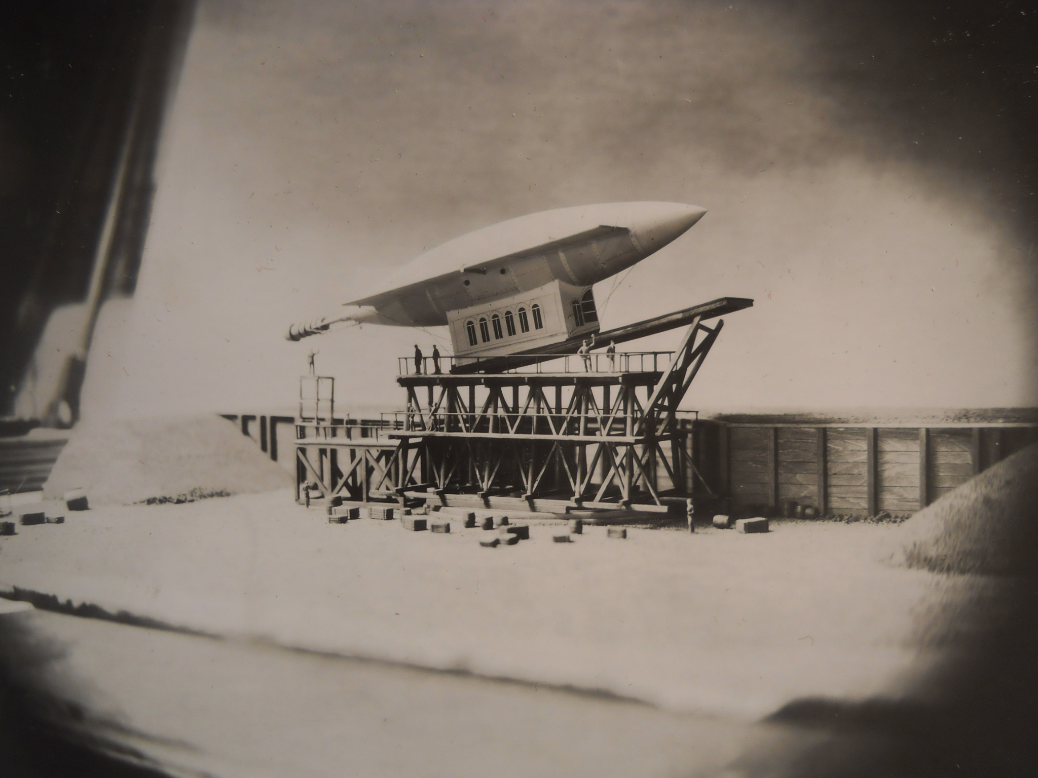

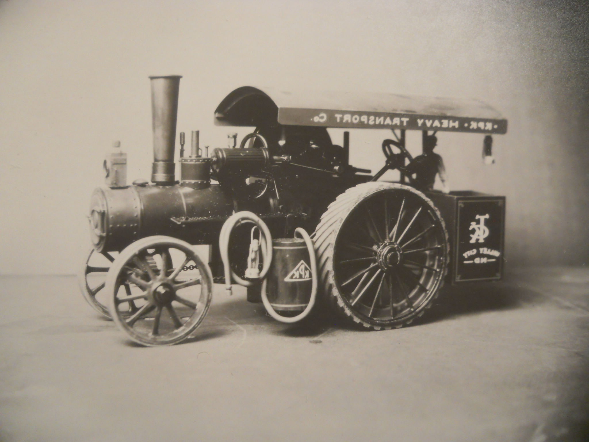

OK, this is what I had posted then removed thinking it was redundant since I found other material on the subject. Reversal
printing is new to me so I am having fun with it. There seem to be several ways of doing this process, my bleach solution is copper sulfate and potassium bromide. So far it has worked only with Arista EDU grade 2 paper, Ilford MG does not behave the same so I ordered 35% HP.
kevin
thanks for uploading those photos !
i can NEVER get enough of this stuff :smile:
john
Thanks. I have some HP on order and will try it with Ilford MG to see how it compairs to what I have been using.
