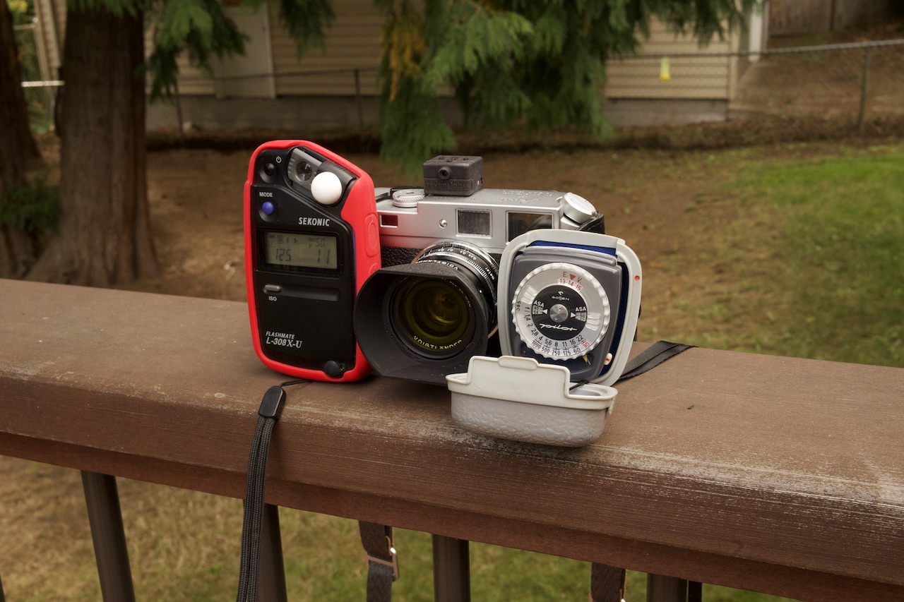

In the photo you can see the fifty-five year old Gossen and the year old Sekonic both show the same reading. The Reveni was off by about half a stop.
