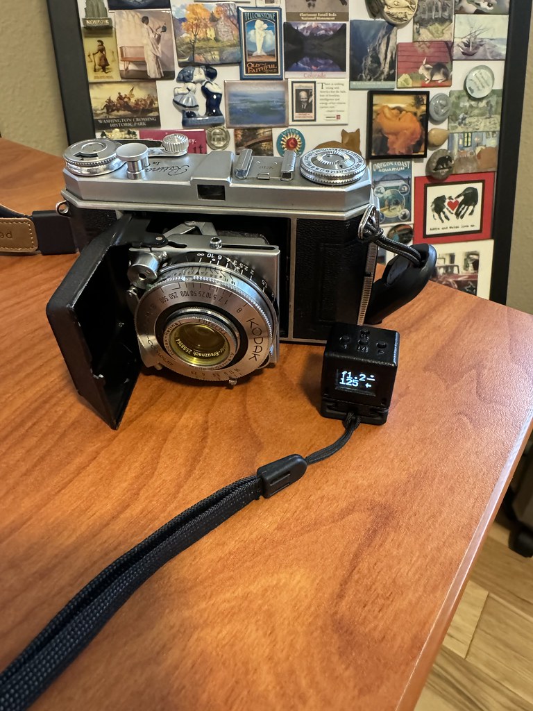

I received my Reveni Labs light meter MK2 yesterday and there are major improvements over the original version. First is the battery life issue has been addressed. The LR44's have been replaced with a USB rechargeable NiMH cell which provides plenty of power to run the OLED screen while providing a much longer run time. The meter is only slightly larger tan the original and the display offers more information. There is a continuous reading mode as well as the press and read. ISO from 1 to 12,800, F stops from .07 to 1K and speeds from 1 hour to 1/8000th. It offers a lot in a small package and I'm looking forward to putting it to use!
