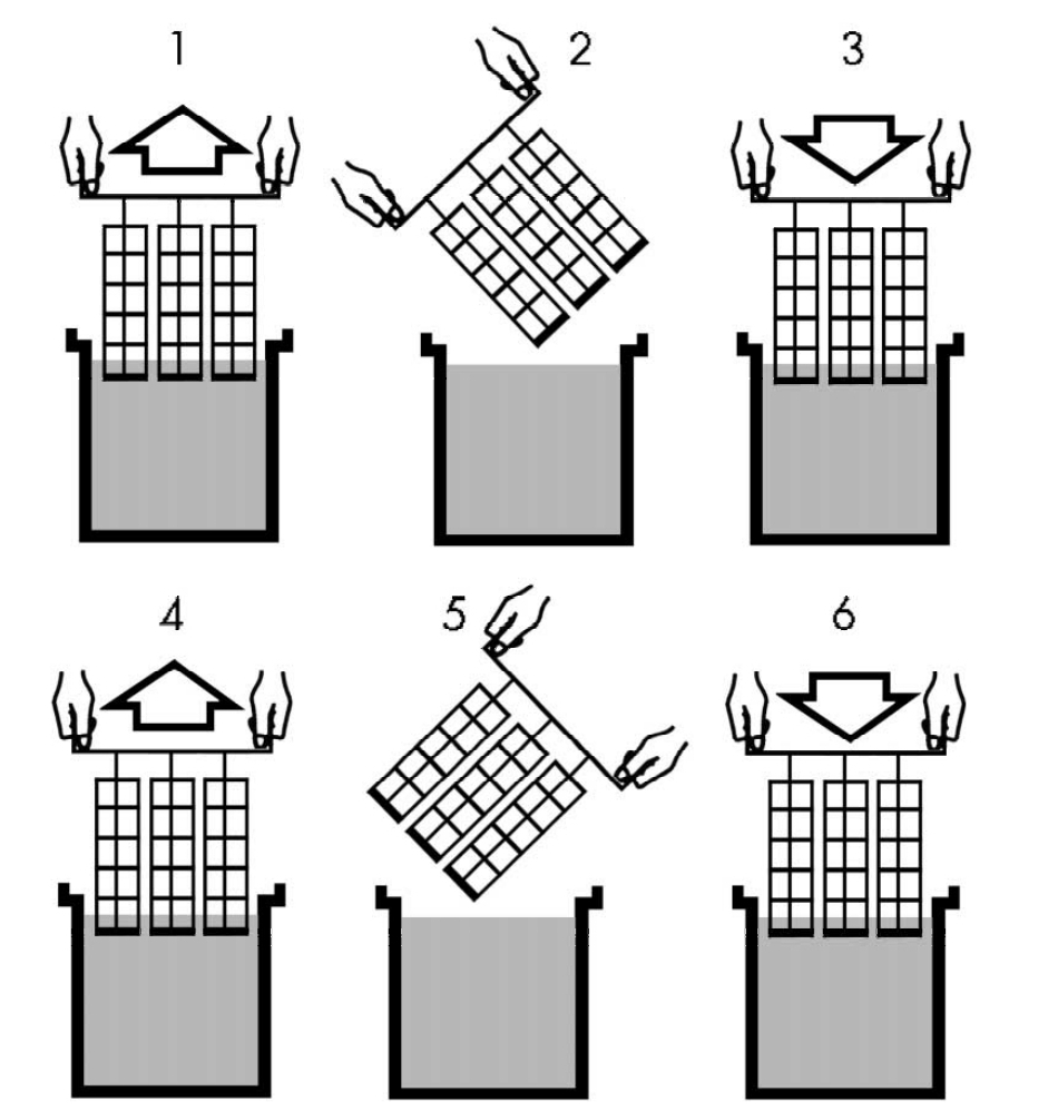

Where is the agitation? I don't see anything happening after dipping the tank into a cylinder. In D&D machines there is gas bubling (air or nitrogen) and in combiplan type you need to lift out the rack like shown below to renew the chemical in contact with the fillm.
