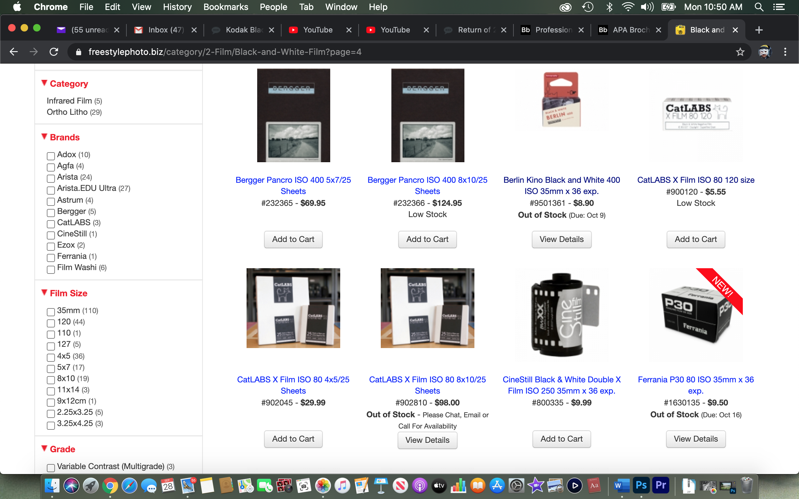

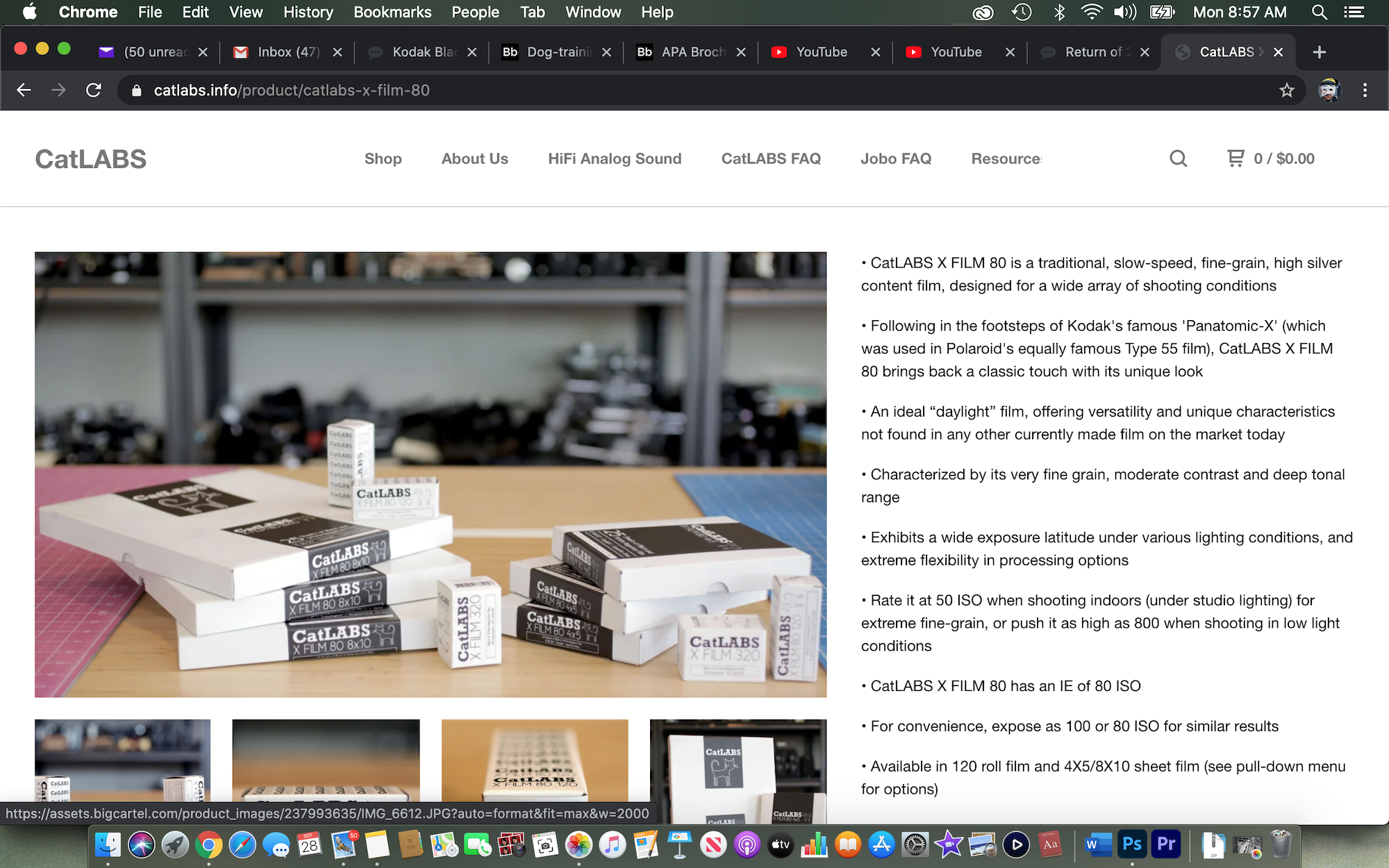

Here's the freestyle photo description for catlabs 80 (aka gp3):
CatLABS X Film 80 is a traditional, slow-speed, fine-grain, high silver content film, designed for a wide array of shooting conditions. Following in the footsteps of Kodak's famous 'Panatomic-X' (which was used in Polaroid's equally famous Type 55 film), CatLABS X Film 80 brings back a classic touch with its unique look. It is an ideal “daylight” film, offering versatility and unique characteristics not found in any other currently made film on the market today.
"following in the footsteps" really could mean anything. Likelihood is someone at Freestyle reads these forums and sees people asking for a return of Panatomic-X....and realises that by making a vague and legally meaningless comparison they can sell more of it.
actually, it's Catlabs wording as the same thing appears on their own site. Obviously a marketing ploy, but still a great film.
