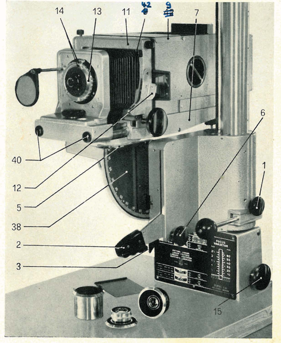

In general the Professional Durst models were either on tracks or free-standing. The Consumer enlargers were table-top.
Some of the 4x5 enlargers were somewhere in the middle; Professional, tabletop enlargers. Like this Labator 45:

Durst Laborators were either tabletop or free-standing, with most 4x5 models being tabletop. All were built to professional standards, and 4x5 was never considered an amateur format in Europe, though it was viewed somewhat differently in the States.
