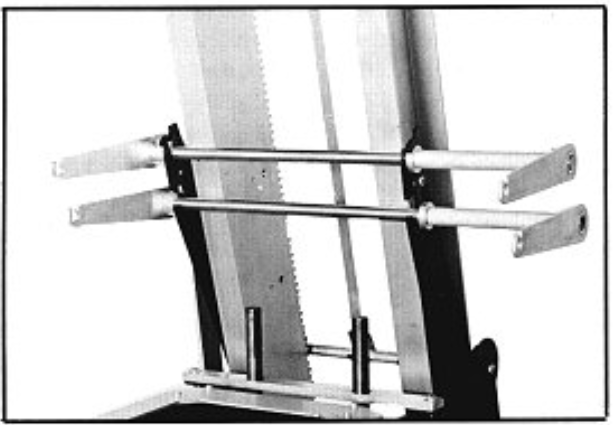

The hardware on the D3 and the Super Chromega Dichroic are SAE. You will need to get longer rods for the lift arms. In the USA, just about any hardware store will have the rods which can be cut with a hacksaw.
The grub screws to remove the arms need an SAE wrench. In place of the long spacers, I used locking collars.

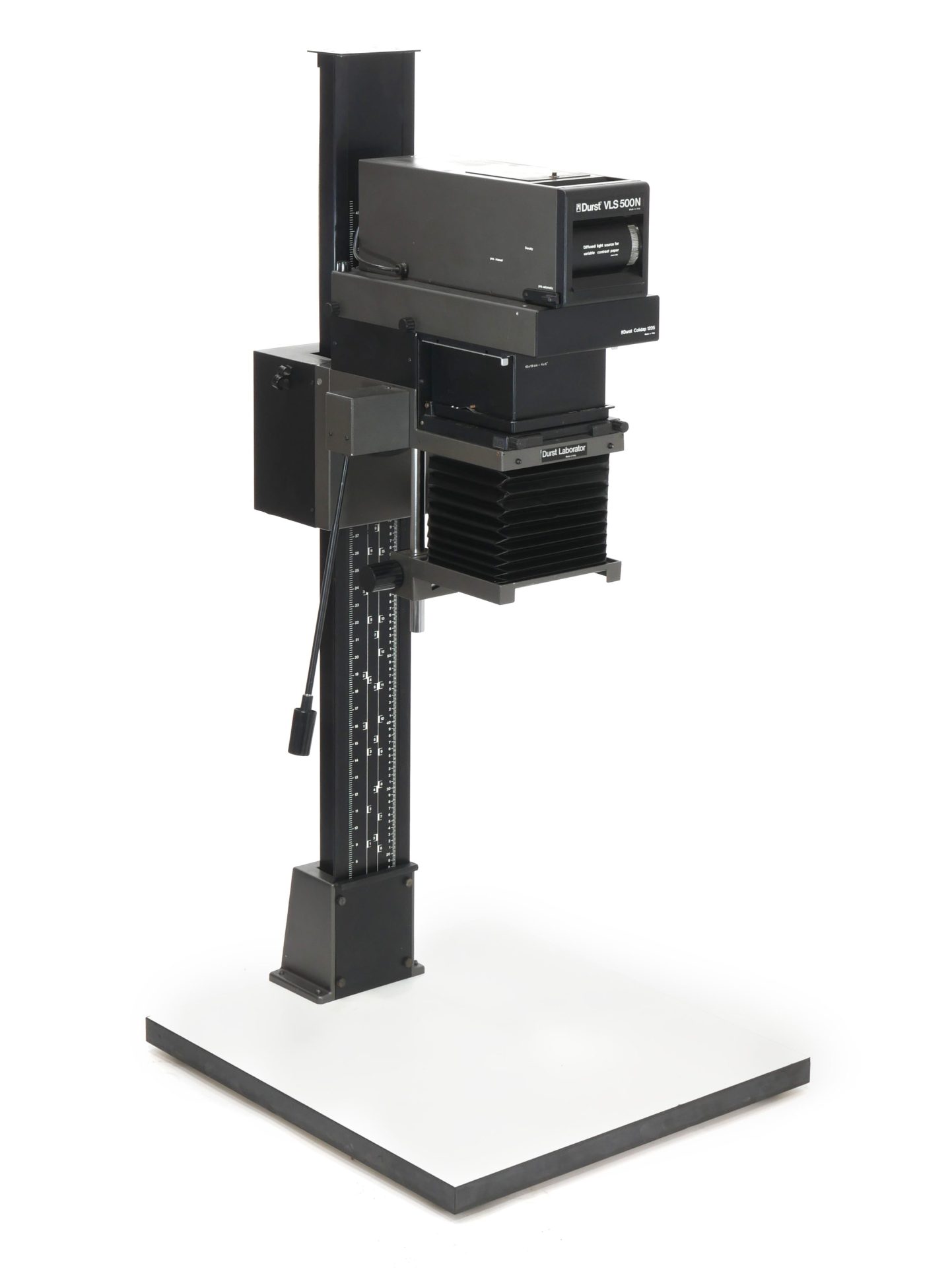

Long tlme ago I took some color darkroom courses at the art school closest to me, they had durst units and a few deveres. I always liked the devere machines best, but the were floor units and the durst machines were bench models so really an unfair match.
DREW WILEY
Jul 14, 2011
14,872
8x10 Format
Hmmm - I've never even seen a Durst bench model, just tall commercial units as well as horizontal ones. However, I'm aware that they did make quite a variety enlargers over the decades.
DREW WILEY
Jul 14, 2011
14,872
8x10 Format
That's not a Durst commercial enlarger at all, but something from their separate amateur division. There are a number of L-series 4x5 bench enlargers in use in the US; I was once offered one for free, but didn't have space for yet another enlarger. Here most such anodized aluminum bench enlargers are Omega, Beseler, and Saunders brand instead - all good quality items, but not built anywhere near to the standards of real commercial or industrial enlargers. With one rare exception, the smallest commercial Dursts were 5x7 inch film capacity, on a 138 chassis. L184 10X10 units were also common; but their industrial enlargers were made clear up to 12X16 inch film size (I've never seen one of those either). I use both L138 5X7 and L184 10X10 floor standing models; most of the components are either machined or diecast. It would be prohibitively expensive to still manufacture such things that way today.
