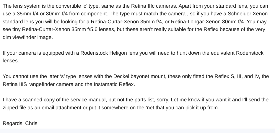

Here is a memo from chris on lenses. My research and collection is Model S is Xenar type lens fit II,IV,IIIs,III, and instamatic. Retina is Xenon , dkl base fits IIc,IIC,IIIC- I also found a 2x accura diamatic extender....Made my Retina tele Zenar 200mm f4.8 into a scope that can view the moon...its fantastic. Love Schneider Lens.
John
Here is Chris
