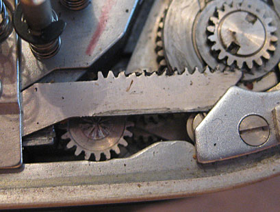

Got this Retina IIc today. Shutter doesn't cock, but nothing obvious inside the shutter. The advance lever isn't turning the cocking gear inside the shutter. Opened the top. So, the teeth are clearly boogered, but the advance lever action is smooth. It just doesn't cock the shutter. Is this the root cause, or is it possible there's something else amiss here.

That was a weak point on the lever wind Retinas. My Retina Reflex S, which I got when they came out, had the racks replaced several times. It was like changing oil in your car.

Microtools used to sell new replacements. Haven't looked at the site for a while, so?

I saw this on another board and there was a link to Microtools for the item.I didn't know that they sold it either,it is a good thing to know.In any case the OP has the info he needs.Ron G

Microtools lists a IIIc cocking rack on their site:
Dead Link Removed
Don't know if that will work on the IIc

Chris Sherlock (retinarepair@gmail.com) would be able to tell you if it would fit on your retina. He CLAs retinas and has worked on some of mine. He's an expert on them.
