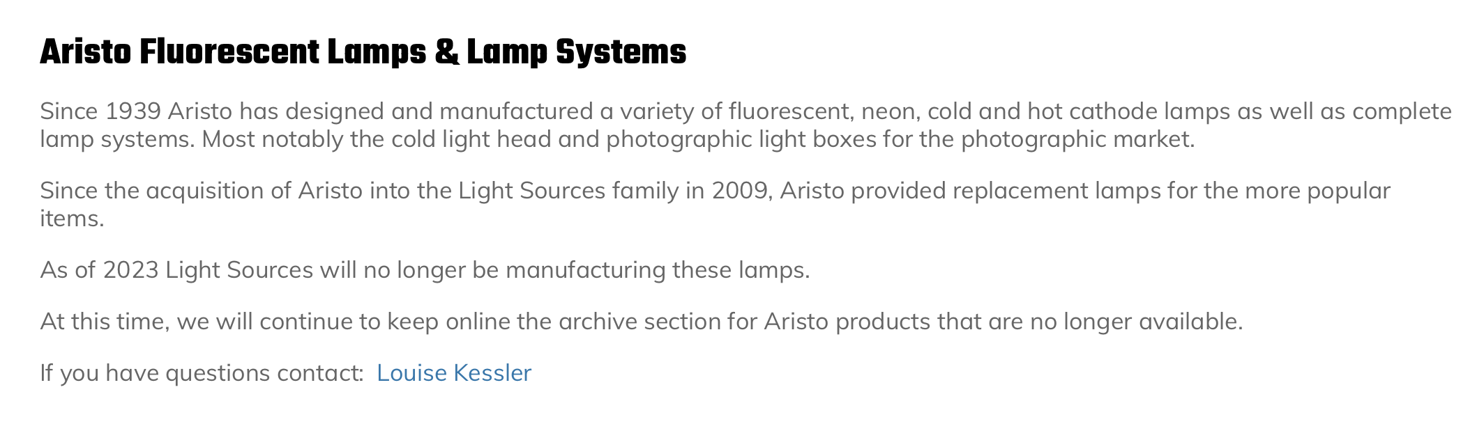

I have much the same experience with the Zone VI VC CL head over about the same timeframe. The concern I have is what do I do when/if it fails. I do have a full condenser head with lenses for my push up Omega D II.
Either contact lightsources & buy a set of spares, or keep an eye out for a colour head in your vicinity... a back up isn't a bad thing.
ic-racer
Feb 25, 2007
16,728
USA
Good luck with that....
